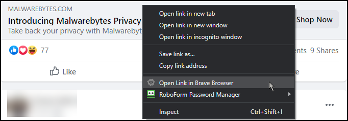

I work with a lot of different browsers for testing purposes so what I'm after is the ability to right-click a link from say, Facebook, and select to open that link with another browser that may not be set as default.
I mostly keep Google Chrome as my default browser, however, it would be particularly useful to be able to right-click a link and select the Brave browser to open links, due to its vastly superior built in Ad Blocker which does not trigger Adblocker warnings on most web sites.
Here's a visual representation of what I'd like to achieve when I right-click a link:
Anyone know if this is possible to achieve and how I could do it?

Avatar of Andrew LeniartAndrew LeniartπŸ‡¦πŸ‡Ί
Jazz,
And Open with Brave:
https://chrome.google.com/webstore/detail/open-in-brave-browser/mgmnomlncpmfgelhofilonnecmbdaoia?hl=en
The above works perfectly and is exactly what I was looking for.
No idea why I couldn't locate that one myself when I went searching so thanks much for finding it for me.
This will save a ton of time manually copying links from Chrome and pasting them into Brave.
I'm a happy camper now. πŸ˜ƒ
