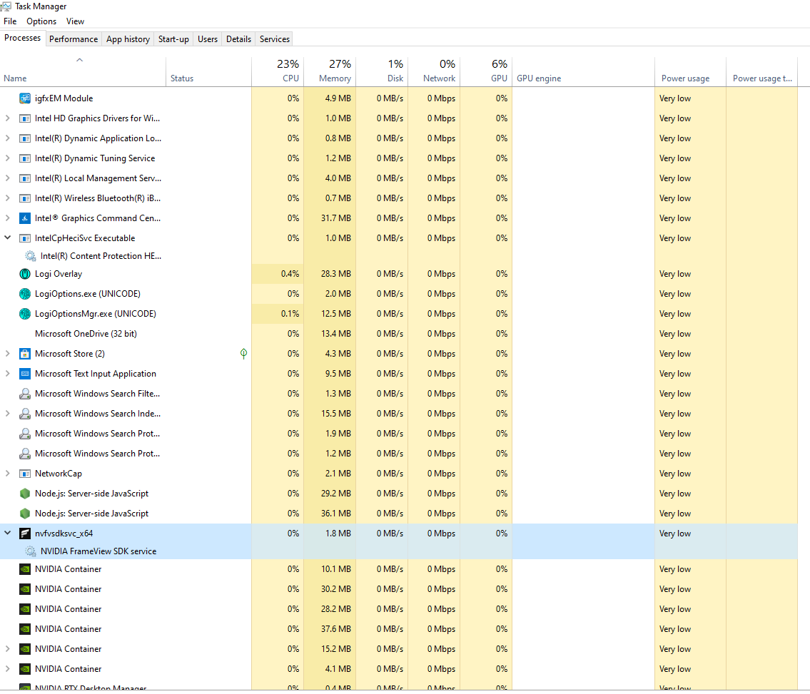

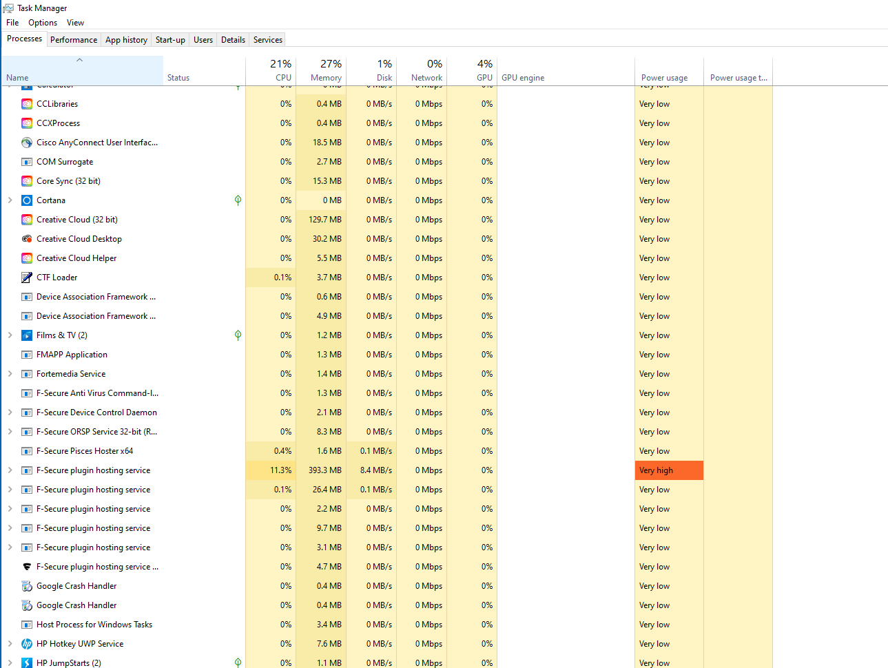

How to find any other GPU running in my computer
Hi Experts,

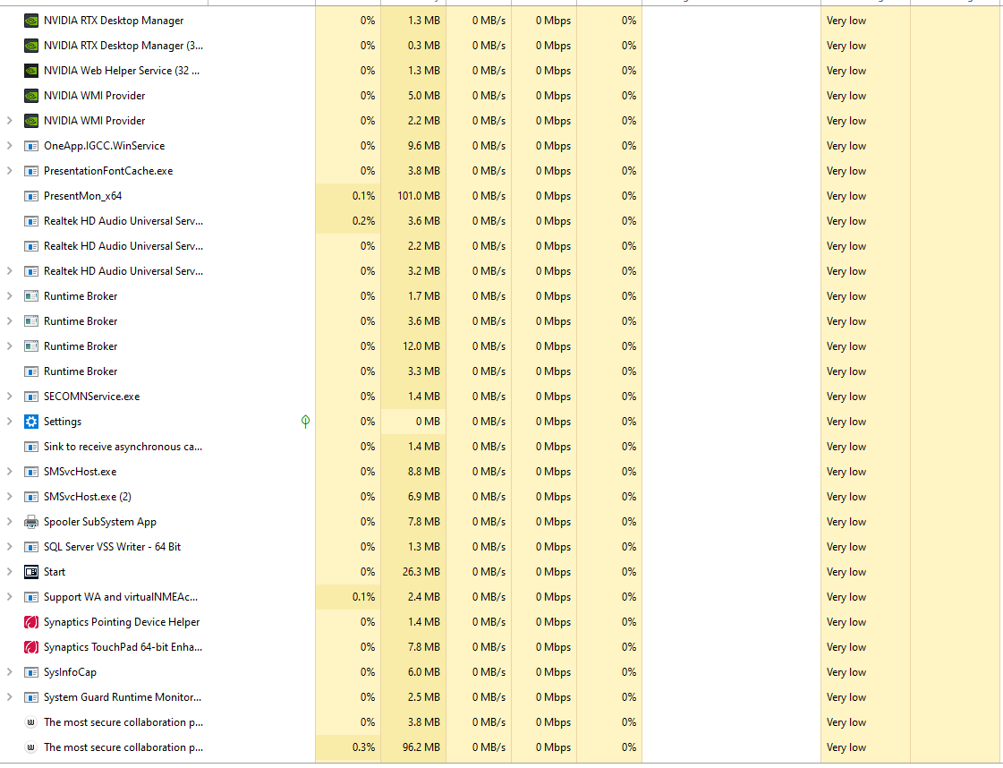

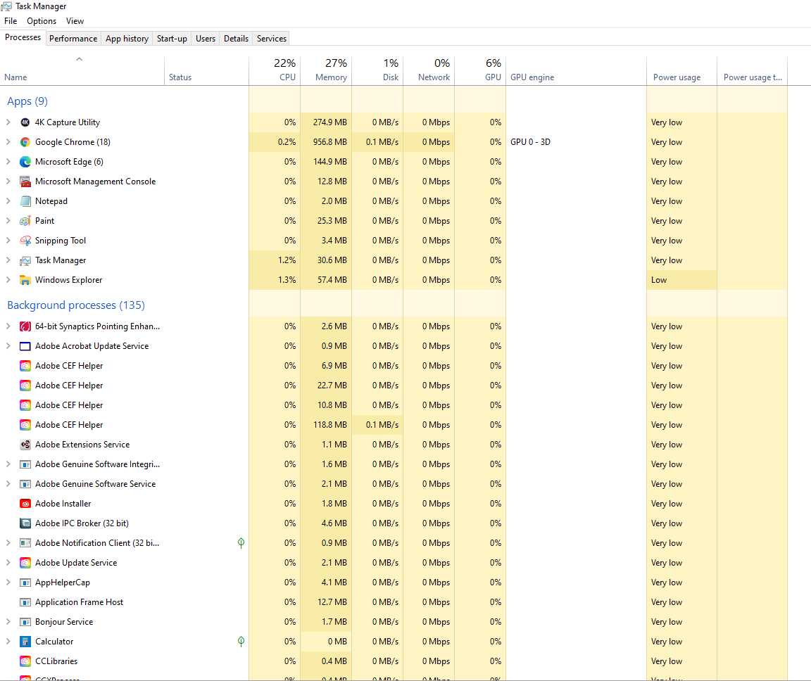

How to find any other GPU runing in my computer other than"4K Capture Utility"? if then found how to remove that. I have attached services in my computer

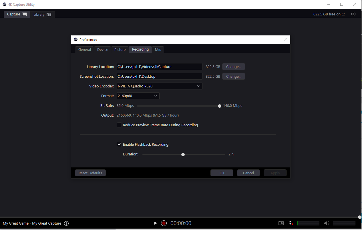

Error is :
Failed to start Recording
Please make sure graphics driver is up-todate and NVDIA Quadro P20 is not in use for vedio encoding by any other
Application
Because i'm i have issue with Capture card there advice below
If you are using Elgato Game Capture 4K60 Pro, have GPU encoding selected, and are running another program such as Skype or a video editor, then that program might be using the GPU as well.  That can cause the recording not to start.
Please exit all video programs, and then try recording again.
User generated imageUser generated imageUser generated imageUser generated imageUser generated imageUser generated imageservices.txt

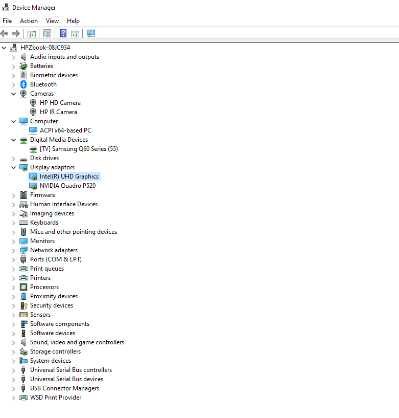

Open Device Manager and disable what you need.
Avatar of ukerandiukerandi🇬🇧
@Hello There

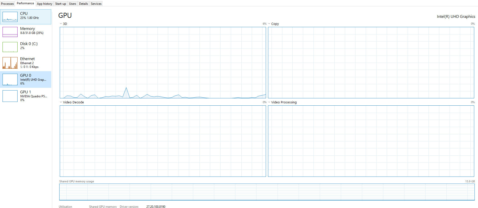

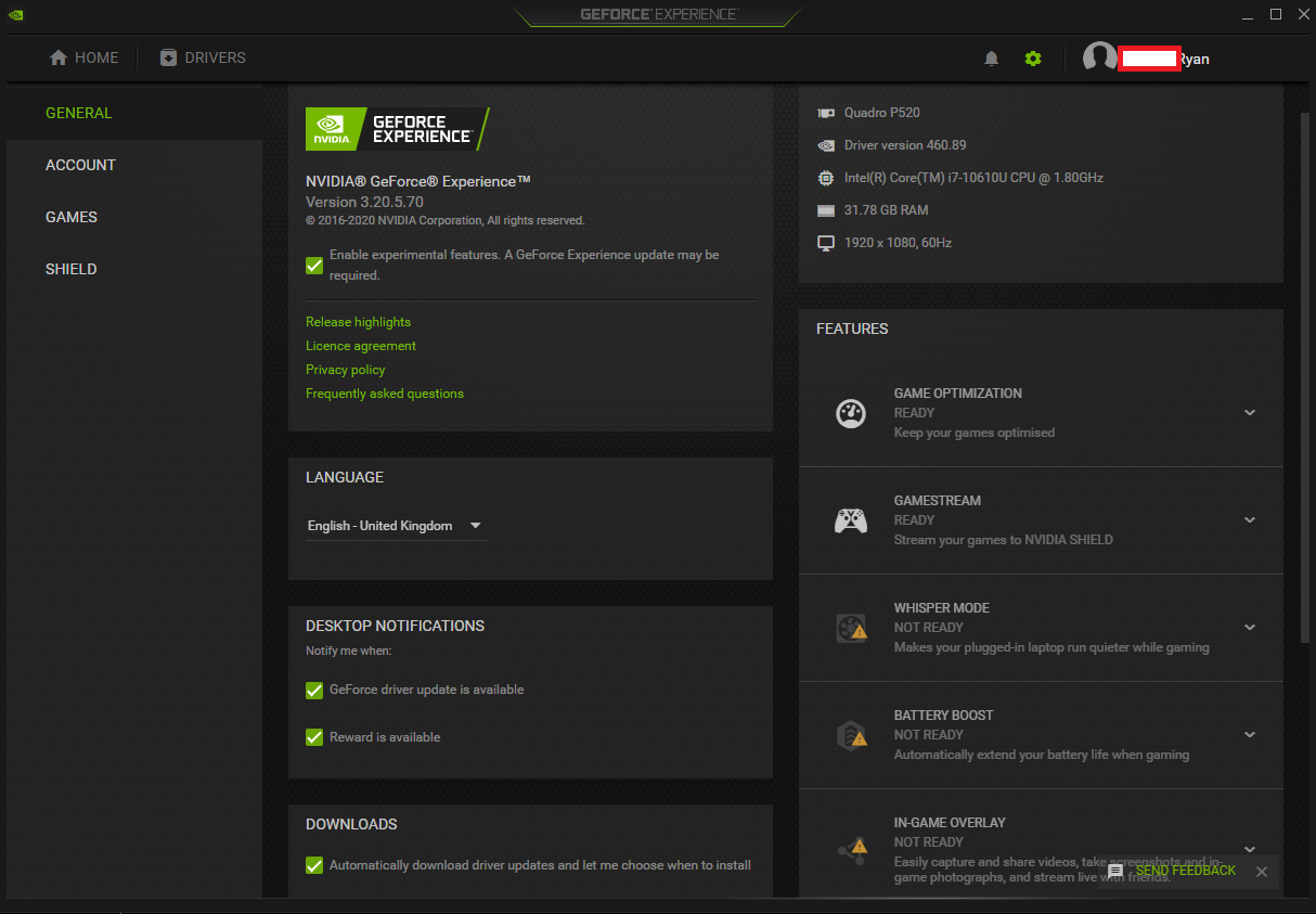

I'm not sure which one need to disable. see attached screenshotUser generated image
It looks like you are using a laptop and do not have the capture card installed into a desktop.
The other gpu is the intel graphics
