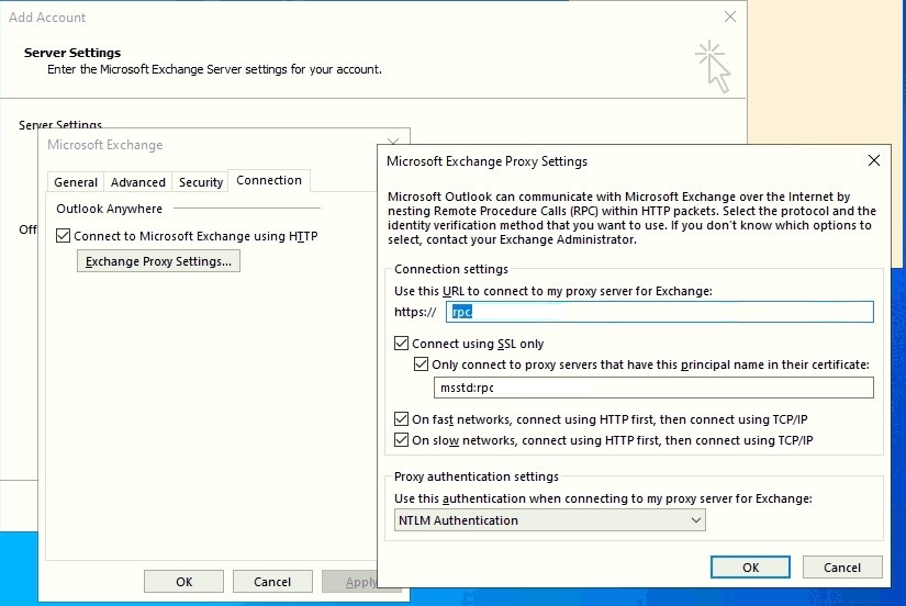

We have migrated the Exchange server from 2010 to 2016 all mailboxes moved and it's working fine with internal users & OWA access. we reissued the SSL Exchange Certificate for 2016 and installed it.
Issue when we try to configure remote uses in outlook its shows the attached errorsOutlok Configure.jpgOutlook Error01.jpgOutlook Error02.jpeg,
In exchange server, we did outlook anywhere setup & configured Virtual Directories.

Thanks for your support - I missed out on point # 5
5. Enter the below command in Exchange Management Shell to see if the Autodicover URLs are set.
once done its works fine on Outlook.
