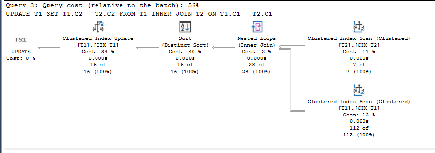

While @Scott is right, that the query plan is compiled and then used, this does not mean that the same value is used.
A simple sample (CIX update) shows that already with a few rows:

Thus for your questions: The query plan, once compiled, can be called deterministic, but NO, the same value does NOT have to be used by it.
Test instance at hands: Microsoft SQL Server 2019 (RTM-GDR) (KB4583458) - 15.0.2080.9 (X64)   Nov  6 2020 16:50:01   Copyright (C) 2019 Microsoft Corporation  Developer Edition (64-bit) on Windows 10 Enterprise 10.0 <X64> (Build 19042: ) (Hypervisor)

It's just a sample, showing that you don't see either a stream aggregate or spool operation. Besides that, the plan is always "consistent" or "deterministic" and these terms make no sense here.
The question was, whether the update uses the same value or not. Nothing more. The physical structure of the data, aka clustered indices is not defined and may change.
Thus, due to the scope of the question without making assumptions: Yes, the value can be the same or not. The query alone does not determine this.
