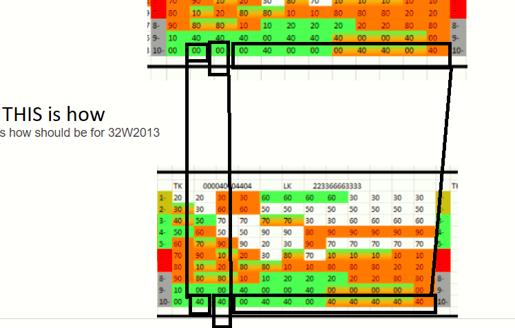

Identify that RANGE PAIRS AND TRI sections in BYPLAY need to be ADJUSTED as shown i did 32W2013 as sample
ADRIANA P
here how is now
rwheeler23
ADRIANA P
here how should be
Martin Liss
If what I did is not correct, why did you select it as the answer?
ADRIANA P
Well the question is with two buttons and the answer has much more done
I just have to adjust some parts
Martin Liss
Is this a change to the requirements? If not please be specific as to what cells are wrong.
ADRIANA P
we have in tha range area this situation
is not counting the correct way
this is how now for 32W2013
this how should be for 32W2013
first day is 019    range is  00  10  because 01 19 09    so 00 then 10  are the first order then the sequence from Mayor to minor
then 480  is 48 80 40  so 40 is leading
as you see the hit numbers have more 40 than 00  that's the correction
00 is the second place in the week same for the others sequences weeks

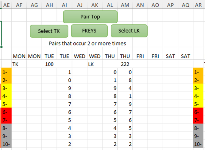

ADRIANA P
i miss sat am  801
Martin Liss
Why is WED AM blank?
ADRIANA P
It is blank because it does not have repetition of pairs at that moment
It is really important to see the pairs and count them at the moment that they only occur
James Murphy
Martin Liss
I don't understand what you just said but why isn't WED AM the same as WED PM?
ADRIANA P
in Pairs Top
I am only interested in counting the pairs that are repeated
if a pair repeats the moment it occurs
example
the first pair that repeats is 01
This repeats on Tuesday PM so I count and show that pair on TUESDAY PM
on Wednesday AM there is no repetition of pairs
therefore I have nothing to tell and I do not show anything
Then on Wednesday PM there is another repetition
So I count all the repeats of those pairs for Wednesday pm
ADRIANA P
for Thursday, Thursday AM there is a repetition so we count all the pairs the repetitions for Thursday AM that are repeated
ADRIANA P
for Thursday PM there is a repetition where a pair so we count all the repetitions of pairs for Thursday PM
when a repetition occurs we count all the pairs that are repeating
when no repetition occurs we do not count anything or show anything

It seems like you are saying that given an ORD like 019 that you don't break it down into 01, 19 and 09 (the 1st 2 digits, the 2nd 2 digits and the first and last digit, you just break it up into 01 and 19 (the 1st 2 digits and the last 2 digits). Is that true? If so 4N is wrong too.
fblack61
ADRIANA P
011   =  01   11
in this case we just looking for the repeats   so the 01  is the repeat  so we used it  to be counted
ADRIANA P
we are  doing  now  PAIRS Top  = repeat PAIRS  for the week
we looking for the PAIRS that repeat for the week then count and shown only the PAIRS that repeat
Martin Liss
What about a number like 019?
ADRIANA P
019  =  01 19  09
we do not change from where the 3N or 4N pairs belong (in the case of 4N) we only identify the PAIRS that are repeated during the week
Here what we are doing is counting as they occur and cumulatively. We count all the PAIRS that REPEAT but have to be in each occurrence in which it is repeated (occurs)

MON AMMON PMTUE AMTUE PMWED AMWED PMTHU AM
019019019019019019019
480480480480480480
255255255255255
011011011011
437437437
201201
079
none repeatnone repeatnone repeat
none repeat
YES REPEAT HERE
YES REPEAT HEREYES!!
01
0101
01
0101
0101
09
09
count as shown
count as shown count as shown
0 2 times
0 3times0 5 times
1 2 times
1 3 times1 3 times
9 2 times
then
then then
00
11
9
99
8
88
7
77
6
66
5
55
44
33
22

Please let me know if the picture in this comment of mine (where I said "my results don't agree with yours") shows the correct results.
Then for Triple Top please show me what week 22W2015 (2 or more times) should look like,

Then for Triple Top please show me what week 22W2015 showing 2 or more times should look like,
MONMONTUETUEWEDWEDTHUTHUFRIFRISATSAT
9
5
8
7
6
ADRIANA P
