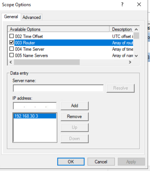

i have a feeling i have a wrong setting: i For the scope setting, the router is suppose to be pointed to the vlan interface correct?
I am able to ping the vlan interface on pfsense (192.168.30.3)

It looks like you have the scopes configured correctly.
Untick the "Append Circuit ID" box on the relay and see what happens.

ok, so I had the vlan 3 scope router pointing to 192.168.5.3 which i switched to 192.168.30.3, now I'm getting "The dns server isnt responding" The dns is pointed to pfsense 192.168.5.3. (When i pointed the dns to the server (192.168.5.6) i couldn't get out to internet because it's not using its own ISP connection and there's a firewall i don't have access to this which was blocking me from getting out to the internet until i pointed it to my pfsense router )
