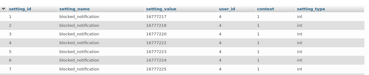

I have a MariaDB database for our Open Journal Server.  It has a table called "notification_subscription_settings" that contains one line per each type of notification that a user selected.
On the screenshot below, a user put a checkmark in "Enable these types of notification" under "New announcement" and under "An issue has been published", but no checkmark in "Do not send me an email for these types of notifications."  This way, they will not only see pop-ups when looking at the journal online BUT ALSO will also automatically receive this notification in email.  That is a default behavior of the site that I want to change, so users only get pop-ups, BUT NO emails, unless they go to their profile and select that option themselves.
I want to insert two entries per those users who have not touched their notification settings, placing a checkmark in "Do not send me an email for these types of notifications."  It will add two rows (one with a "8" and one with a "268435477")  to the database so it looks like this:
setting_id, setting_name, setting_value, user_id, context, setting_type
(469, 'blocked_emailed_notification', '8', 3747, 8, 'int'),
(470, 'blocked_emailed_notification', '268435477', 3747, 8, 'int');
The setting_id needs to start from 471 and get increased by 1 with each new row. The user_id needs to be taken from a list of a few hundred users that I have ready in a text file.
How can I do it in PHPMyAdmin?

Here is the table structure:
idselect_typetabletypepossible_keyskeykey_lenrefrowsExtra
1SIMPLEnotification_subscription_settingsindexNULLPRIMARY8NULL412
The last few rows of data are:
For each selection that is not a default that is made by a user, the system creates an entry with the setting name and a hexadecimal setting value taken from the PKPNotification.inc.php file (I attached that file with binary to hexadecimal conversion).  Some user_ids don't have any entry in the notification_subscription_settings table, some might have up to 12, depending on the combination they selected to edit the defaults.  ("context" is just the number of the journal to which these users subscribe, so it is the same for everyone).
Below is what it looks like when I exported it for a couple users.

So, I need to start from 472 and it should autoincrement. Attached is the list of 1240 user_ids in a csv file.  I would like to add 2480 entries to the notification_subscription_table that would look something like this, with user_id pulled from the user_id.csv file:
"setting_id";"blocked_emailed_notification";"8";"user_id";"8";"int"
"setting_id";"blocked_emailed_notification";"268435477";"user_id";"8";"int"
Additionally, I created a csv file (rows_to_batch_load.csv), attached, that has starts with 472 and creates 2 lines for everyone.  Can I run the following command?
LOAD DATA INFILE 'rows_to_batch_load.csv' INTO TABLE notificaiton_subscription_settings FIELDS TERMINATED BY ',' ENCLOSED BY '"' LINES TERMINATED BY '/n';
