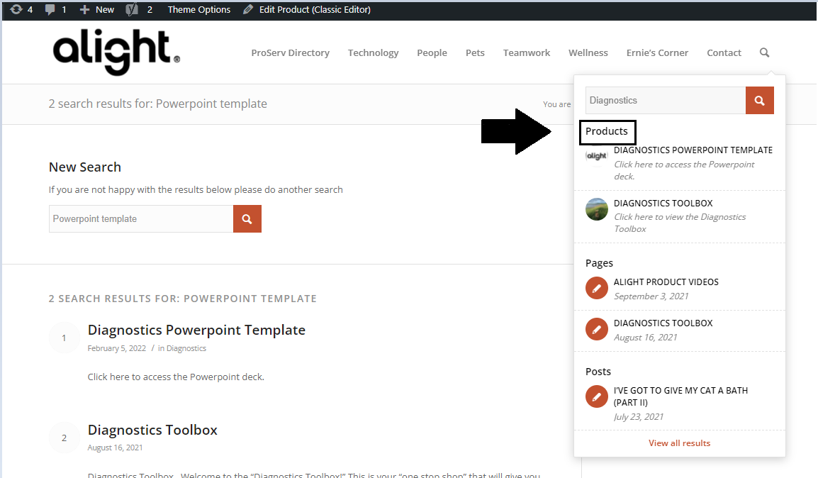

How can I change the way search results are listed in Woo Commerce?
I'm using WooCommerce as a directory and I want the search results to show up differently.
Right now, when you do a search, you get this:
Rather than saying, "Products," I'd like it to say, "Resources." How can I change that?
Thanks!

See if this helps. In the form below. It looks like the code is echoing 'Search Products…' but I don't see that in your example. You could try changing Products to Resources but I would be cautious & maybe copy the line input line or the entire form and comment it out before making the change on the copy.

Bruce Gust
Thank you, gentlemen!
Here's what I did:
I couldn't figure out how to eliminate the "Products" dynamic on the default tooltip, even with your suggestions, but...
...your input inspired a different direction and it turned out to be a winner.
I disabled the search icon using the Theme's option and then I installed a plugin that searched the Woo Commerce catalog only. I could dictate how the results were displayed with that approach.
As far as the default functionality, I downloaded another plugin that allowed me to attach an image to a menu item. I used the conventional magnifying glass and attached the link that opened up a search page. The page displays whatever the user is looking for without the headings that were my nemesis in the tooltip.
So, I may have taken the long way around to get it done, but I was able to make it happen!
Thanks for your help!
