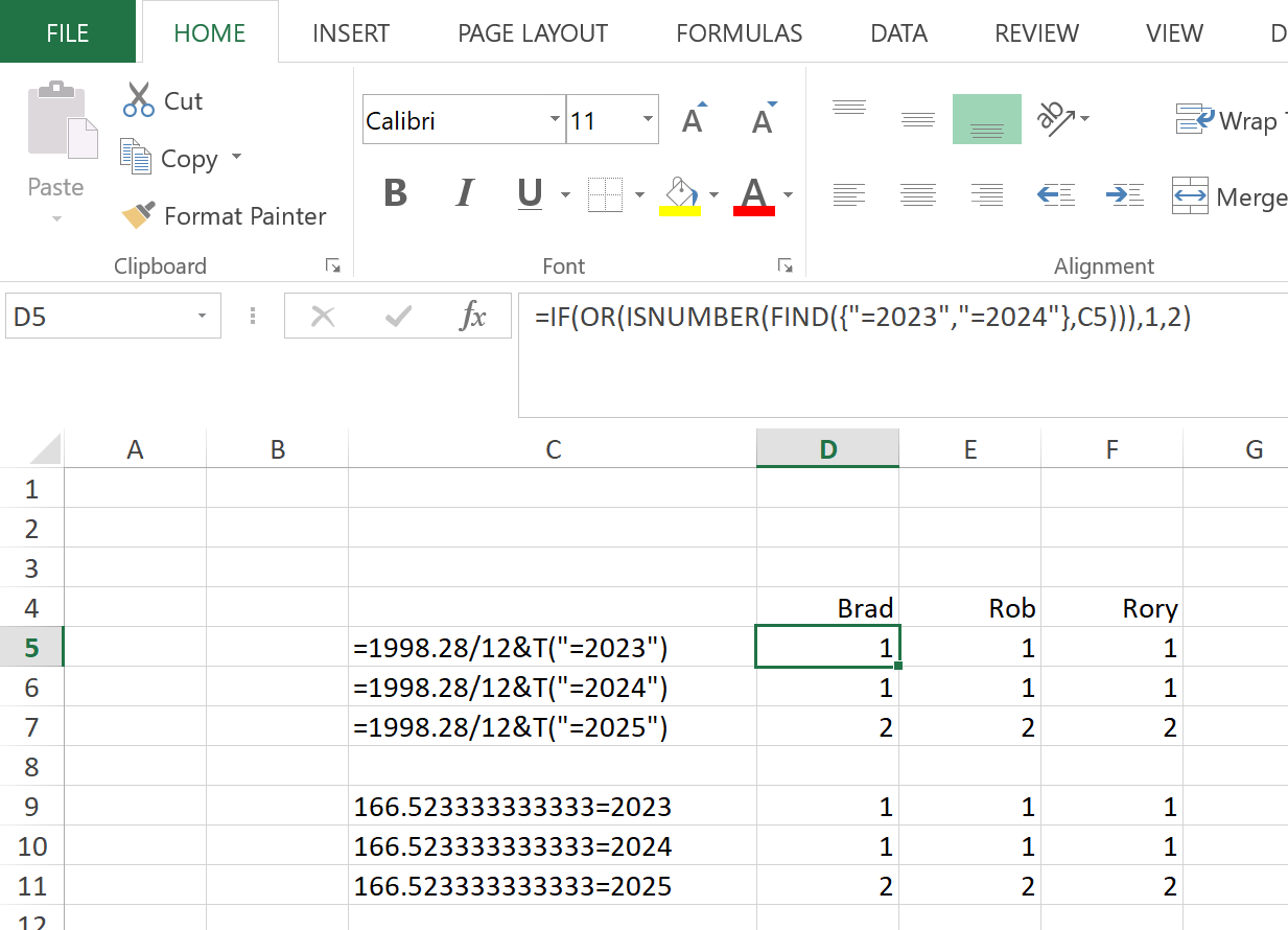

Avatar of byundtbyundt🇺🇸
Both my formula and Rory's work just fine as regular formulas. And as you can see from the screenshot (taken in Excel 2013), the formulas in rows 5 through 7 return 1 for test strings that contain either =2023 or =2024, and 2 if the test string contains neither.
The test strings you posted are also a valid Excel formula. When I allowed the test data formulas to evaluate, the suggested formulas that were supposed to return 1 or 2 still worked as intended. See rows 9 to 11 in the screenshot below.

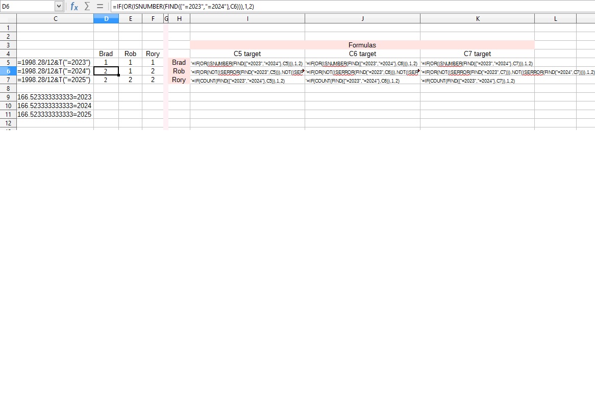

Great. I used to programme turnkey spreadsheets in Lotus 1-2-3, Improv and Excel for many years. Of course I also tried to test what I did. But that was 30 years ago, or more. But perhaps the point you are missing on, is that I have a source cell which has both 2023 and 2024 at the same time. That was why, in my original post, the OR function is used. It looks to me like only Rob got that jist . . . I don't know . . . but you can see on this screenshot the results I have coming out of my machine.

It's a LibreOffice jobbie, saved in .ods file format. The Help version tag is :
Version: 6.1.2.1 (x64)
Build ID: 65905a128db06ba48db947242809d14d3f9a93fe
CPU threads: 4; OS: Windows 6.3; UI render: default;
Locale: en-GB (en_GB); Calc: CL
Krakatoa,
Thank you very much for bearing with me in the issue of why the suggested formulas don't work.
I lay the ultimate responsibility at the feet of the LibreOffice developers, because they aren't 100% compatible with Excel. Specifically, they aren't performing array-lifting.
In such a situation, you are quite correct to use Mr. Henson's formula.
