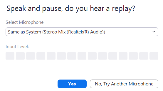

I open "Zoom" application that is installed in my laptop.  I click on "New Meeting".  I get following message:
"Failed to detect your microphone.  Please make sure microphone is properly connected."
I get Two options:  "Check My Audio Devices" and "Cancel".  I select "Check My Audio Devices".
I click on "Test Speaker".  I can hear the test sound.
The "Test Mic" is disabled.

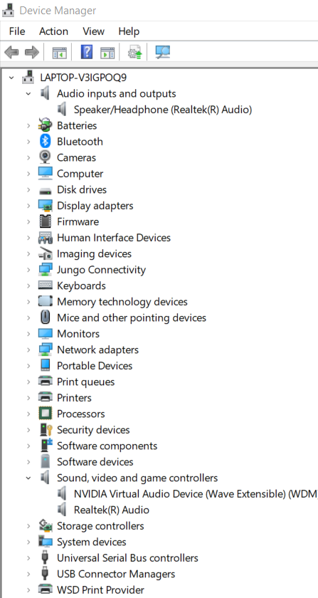

From Device Manager, I click on "Audio inputs and outputs".  Then, it shows Speaker/Headphone.  I don't see microphone.

"Other Device" is not one of the options in my device manager.  Please see attached filename:  Device_Manager_no_microphone.

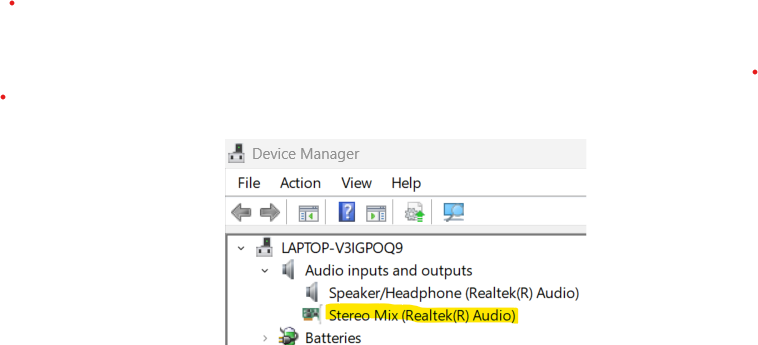

I hear this constant humming sound (I can't really explain what type of sound it is) and now the microphone appears in the Device Manager.  Please see attached filename:  Device_Manager_microphone

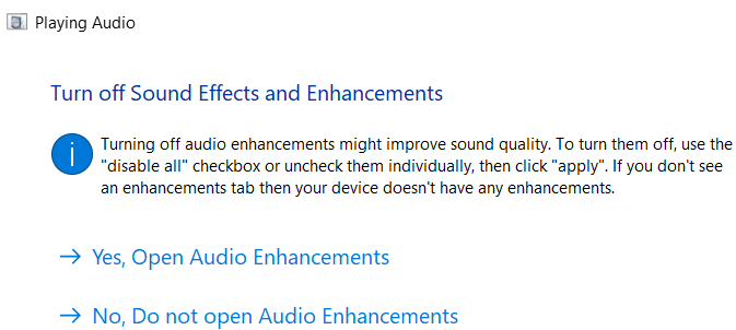

  • I right clicked on speaker icon (lower right hand corner).  Response was "Playing Audio".  Please see attached filename: Microphone_test_by_right_click_speaker_icon

Since the microphone test failed from zoom, I didn't try zoom call.  Please see attached filename:  Microphone_test_from_zoom

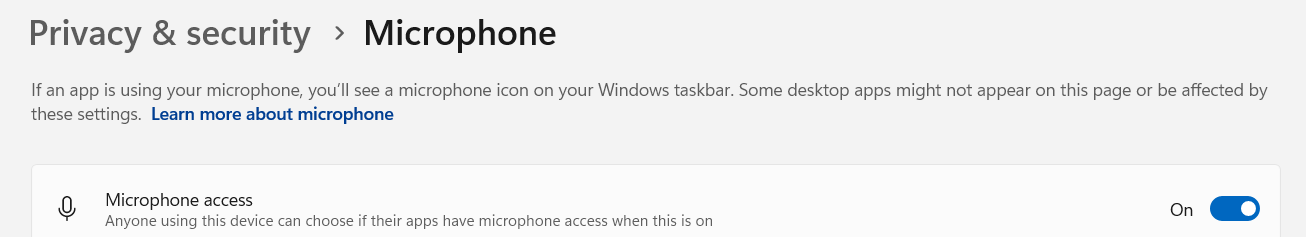

Yes.  Please see attached filename:  Microphone_access

I opened Settings ―> System ―> Sound
There was no "Test your microphone options".  So I did the following:
  1. I went to "Advanced" -> "Troubleshoot common sound problems" -> Input Devices.  I answer 'Yes' to question, "Do we have your consent to proceed with the diagnostics and try automated steps to fix the problem?"  System scanned the device and I heard the tone.

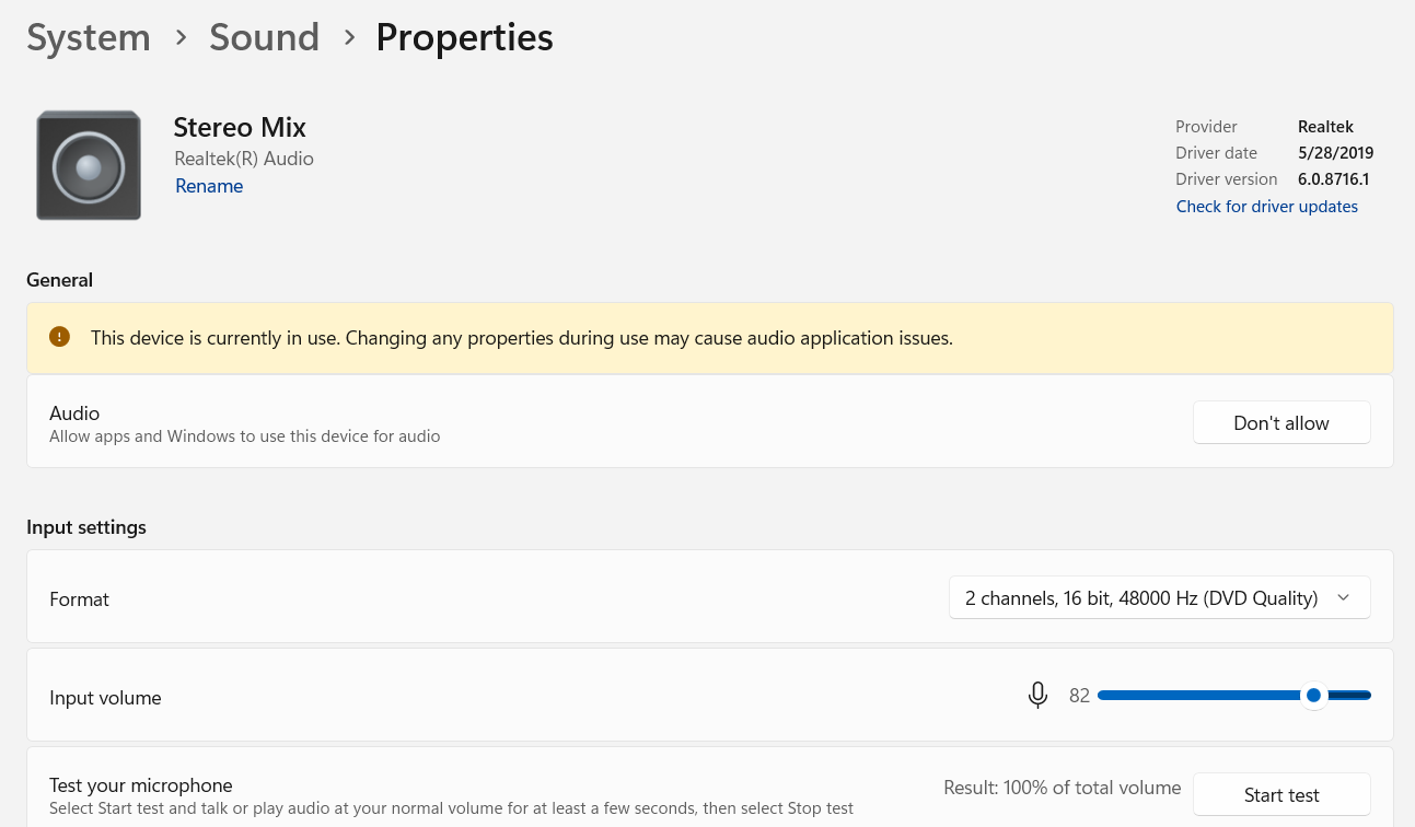

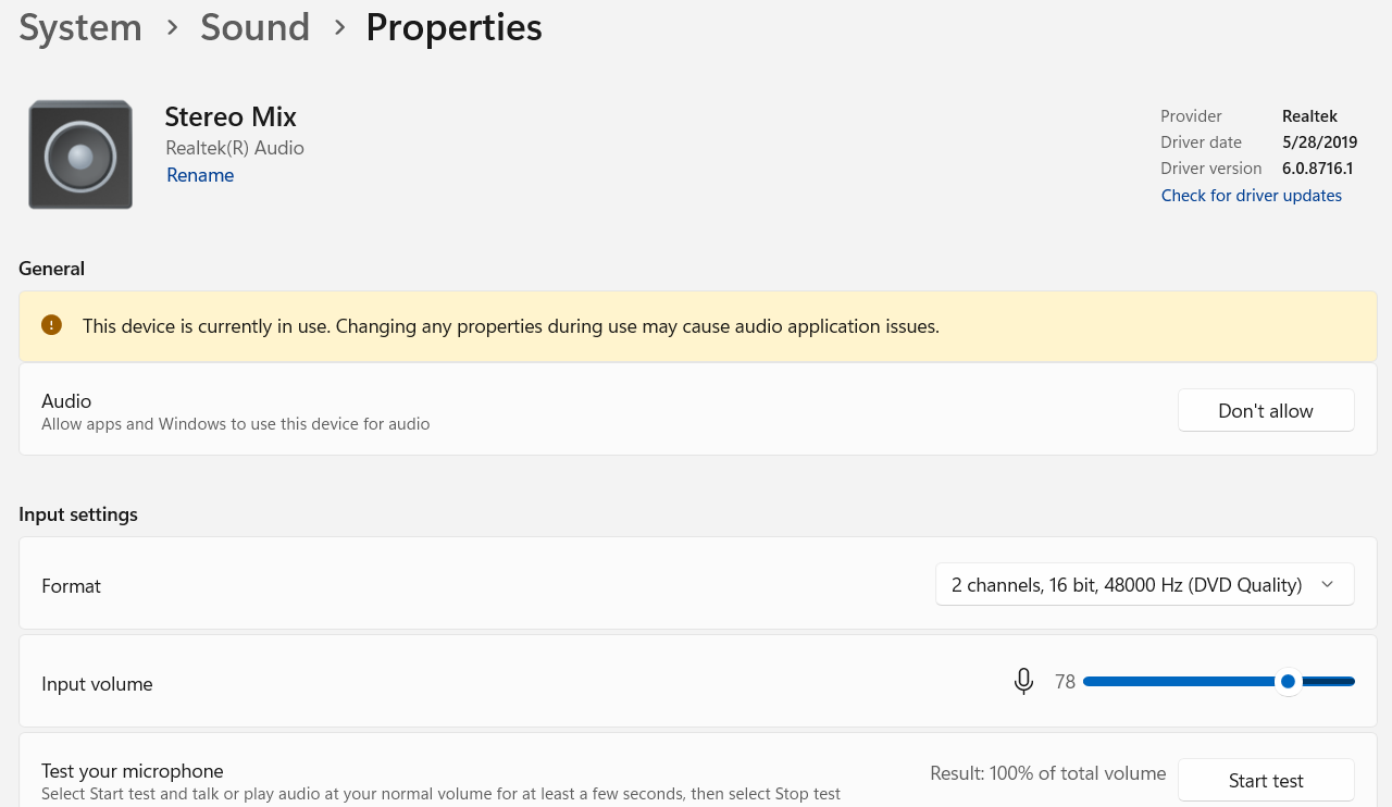

  2. I went to "Advanced" -> "All sound device" -> "Input device" -> "Stereo mix Realtek Audio.  From "Test the microphone" -> "Start Test".  Result was 100% of total volume.  There is also alert in red color that this device is currently in use.
  3. I went to "Advanced" -> "All sound device" -> "Input device" -> "Microphone Array".  From "Test the microphone" -> "Start Test".  Result was 0% of total volume.

I went to Settings -> System -> Sound -> Advanced -> All Sound Devices:
There are two input devices.  I selected Stereo Mix.  There was some red flag and it said device is in use.  So, for the Audio, I selected, Don't Allow.
