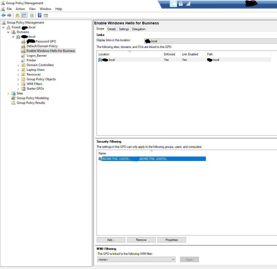

Avatar of Michael LouisMichael Louis🇨🇦
I ran gpresult.exe /R and I can see that my computer has received the GPO I created following the steps in your link.
I have 2 test users I have added to the " biometric users" global security group is AD.  ( my AD account is one of the test users )
When I reboot .. I still do not get a option for fingerprint.     Only for PIN and normal password...  and I need to click on OTHER USER in order to see sign-in options as a option.
