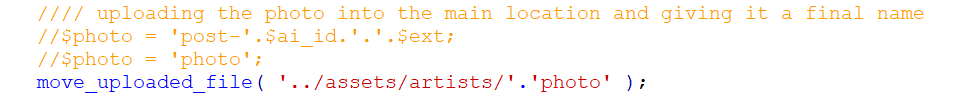

I am trying to upload an image to a field in a table.  The field is called photo.  I do not want to rename it or anything else.  Just a direct upload from a folder on the computer. The folder is as follows. assets/artists/
move_uploaded_file( '../assets/artists/'.'photo' );

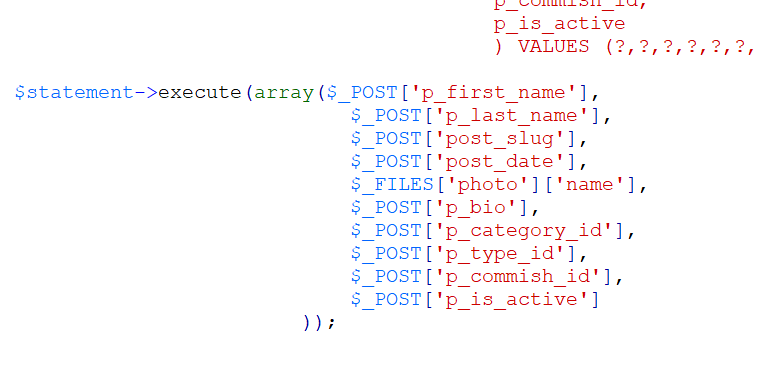

$statement->execute(array($_POST['p_first_name'],
										$_POST['p_last_name'],
$_POST['post_slug'],
$_POST['post_date'],
$_POST['photo'],
$_POST['p_bio'],
$_POST['p_category_id'],
$_POST['p_type_id'],
$_POST['p_commish_id'],
$_POST['p_is_active']
Avatar of Chris StanyonChris Stanyon🇬🇧
Hey David,
First thing - you have 9 placeholders (question marks), and 10 columns, so that needs sorting out.
Now, onto your problem. To upload a file from an HTML form, you need to have a File Input element:
<input type="file" name="photo">
When your form is posted (submitted), the normal fields (input / select / radio etc) become part of the POST array. However - a file input becomes part of the FILES array, so needs treating differently to the other fields. You would need to access the data like so:
$_FILES['photo']['name']
$_FILES['photo']['size']
$_FILES['photo']['tmp_name']
Basically, you won't have a $_POST['photo'] in the submitted data.
FYI - your move_uploaded_file line is also wrong - your need 2 parts for the - FROM (the tmp_name bit), and the TO bit

Ok fixed the “?” part.  Added this…
This seems to be the problem…
I have the file on my local computer. Just trying to insert that file into the computer so that in the ‘photo’ field in the table it reads as such.
Tried this.. did not work.
$photo = $ai_id.'.'.$ext;
OK,
2 moving parts to this question.
Inserting the data into the DB - I'm guessing we've got that part sorted by fixing the placeholders and by including the correct filename value.
The other part is doing something useful with the Uploaded file. When you upload a file like this, it initially goes to your temp folder, along with a temp name. This name is passed to your script as $_FILES['photo']['tmp_name']. To move that file to a location of your choosing, you need to call the move_uploaded_file function - this function takes 2 arguments : where you want to copy the file FROM and where you want to copy the file TO - look at your code and you're only passing in 1 argument - the FROM bit
The FROM part will always be the tmp_name value from $_FILES, because that's where the file got uploaded to. The TO part is similar to what you have above, so what you need is more like this:
$from = $_FILES['photo']['tmp_name'];
$to = '../assets/artists/' . $_FILES['photo']['name'];
move_uploaded_file($from, $to);
You may want to use some logic to rename the file differently - the code above will simply use the original name (mark_adams.jpg for example) - but if you do that, make sure you're inserting the correct value into your DB

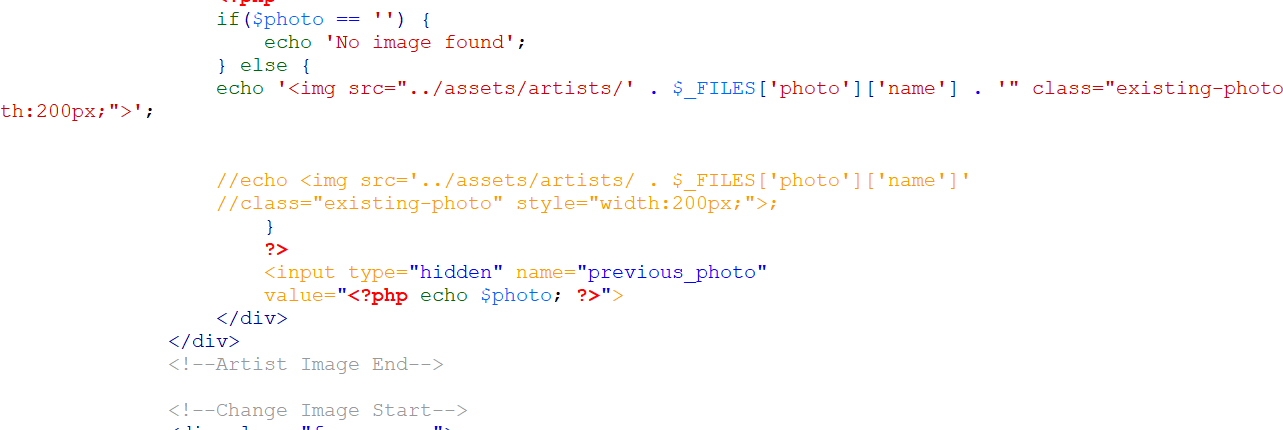

Worked perfectly Chris. Thank you.  Trying to bring it up from the edit page. I think I have my quotes wrong. Have been playing with them but no luck.
if($photo == '') {
      	echo 'No image found';
        } else {
        echo '<img src=../assets/artists/ . $_FILES['photo']['name']
class="existing-photo" style="width:200px;">';
<input type="hidden" name="previous_photo"
value="<?php echo $photo['name']; ?>">
</div>
Yeah - your quotes are looking a little off
echo '<img src="../assets/artists/' . $_FILES['photo']['name'] . '" class="existing-photo" style="width:200px;">';
Here's a slighter better (more advanced way to do it). In PHP, you have a function called printf(). It's a bit like echo, but it allows you to use placeholders and makes it easier than concatenating (joining) different strings together. Basically, you just use %s as a placeholder, and then pass in the value as a second argument, so this:
printf('<img src="../assets/artists/%s" class="existing-photo" style="width:200px;">', $_FILES['photo']['name']);
You can see we have our string containing the placeholder as the first argument and then we have the actual value as the second argument.
You may or may not find it easier, but for me - it's gives cleaner code - particularly when messing around with quotes inside quotes etc.

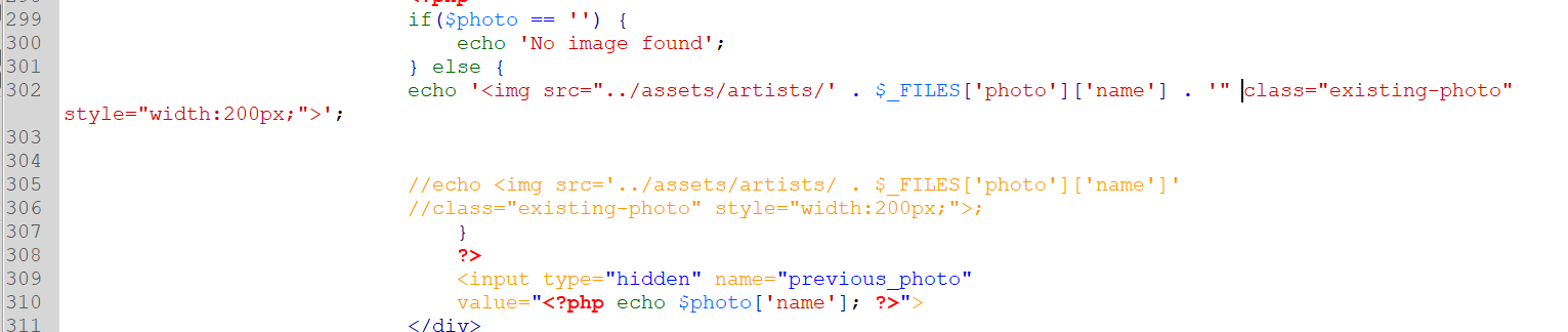

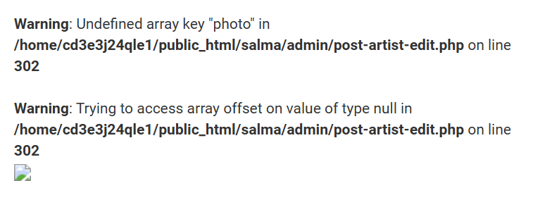

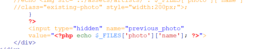

Thank you Chris.  Any tool helps me.  I added the code and in return I received this error message.
OK - the $_FILES['photo'] array will only exist if you've submitted a File Input called photo with a file selected.
Looking at your code above and you've got $photo['name'] and $_FILES['photo']['name'], so I'm not sure where you're at with this.
So. Are you saying that I have two different names here?  Basically the edit page displays the image that we added with the previous code.  So I removed the ['name'] part…
But that still left an error message.  In over my head here.
I've lost track of what code you have as it seems we're looking at different pages here.
As I understand it, you have a page that contains a form that has a File Upload HTML element called photo. When you submit that form, the receiving page (either self or another one) then has access to that Form's data - the fields are part of the POST array and the File is part of the FILES array. At that point, you move the uploaded file to somewhere, and insert the data (including the filename) into the DB.
I don't really know where an ‘edit’ page comes into play here. Explain your pages. Is the code you've just posted on the same page as the code in your opening question?
Hi Chris.  The first page is adding an image.  post-artist-add.php
This file is viewed on the post-artist.php page.  On this page there is an edit button.  This takes you to the post-artist-edit.php page  this is where the problem is.  The other two pages work well.  The problem is with the edit page where the image Mark_Adams.jpg is suppose to be displayed.  I am attaching the post-artist-edit.php page.  The one that is getting the error
updated

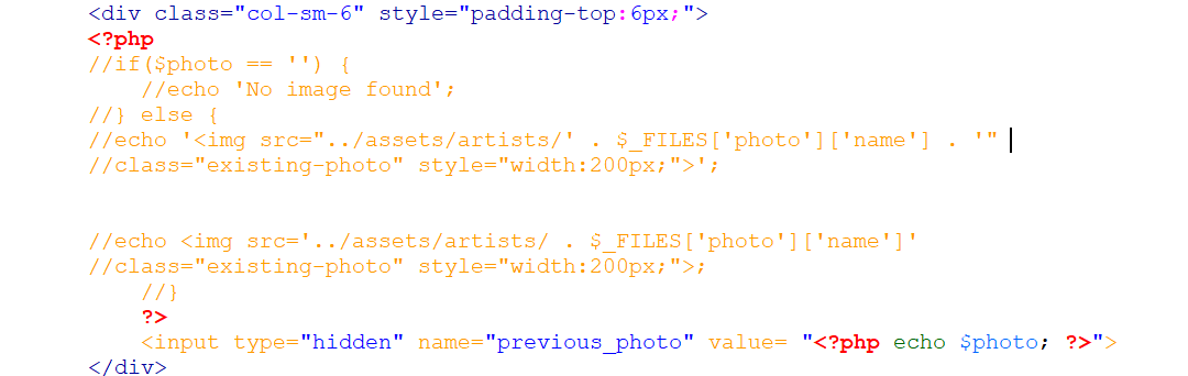

When I isolate this code I no longer receive an error code.
So I would say the problem lies here.  Just need to grab and display the image in the table….
Hi Chris.  I figured it out! Yeah!  This worked. Thank you for your help!
echo '<img src="../assets/artists/'.$photo.'" class="existing-photo" style="width:200px;">';
