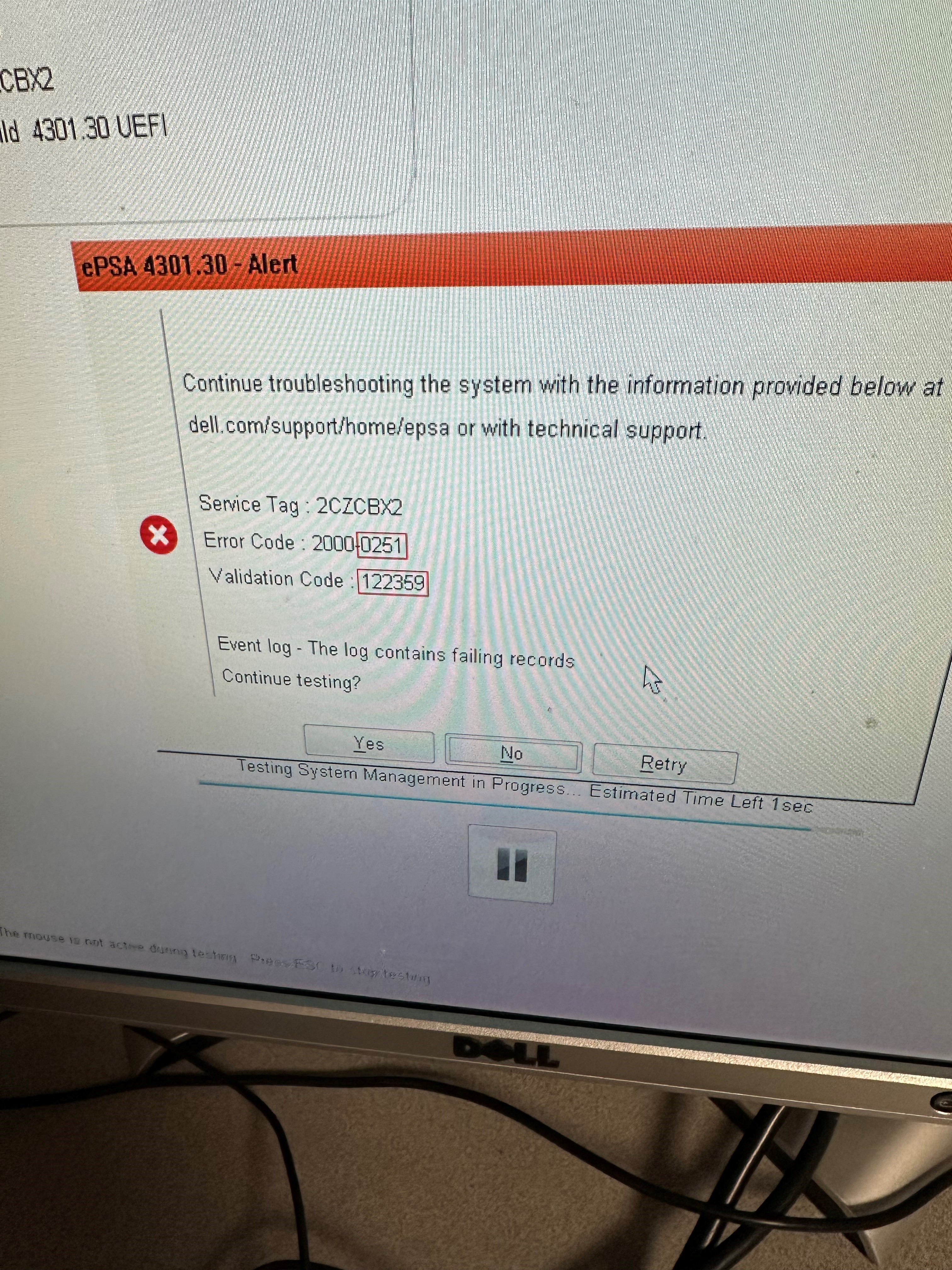

I ran the system diagnostics and got the following code. I've also attached a screenshot of the error.
Error : 2000-0251
Validation Code: 122359
There appears to be an error with the boot partition, but I'm unsure how to repair it. I've tried using the OS disc to run a repair and have also tried bootrec /fixmbr, bootrec /fixboot, and bootrec /rebuildbcd.

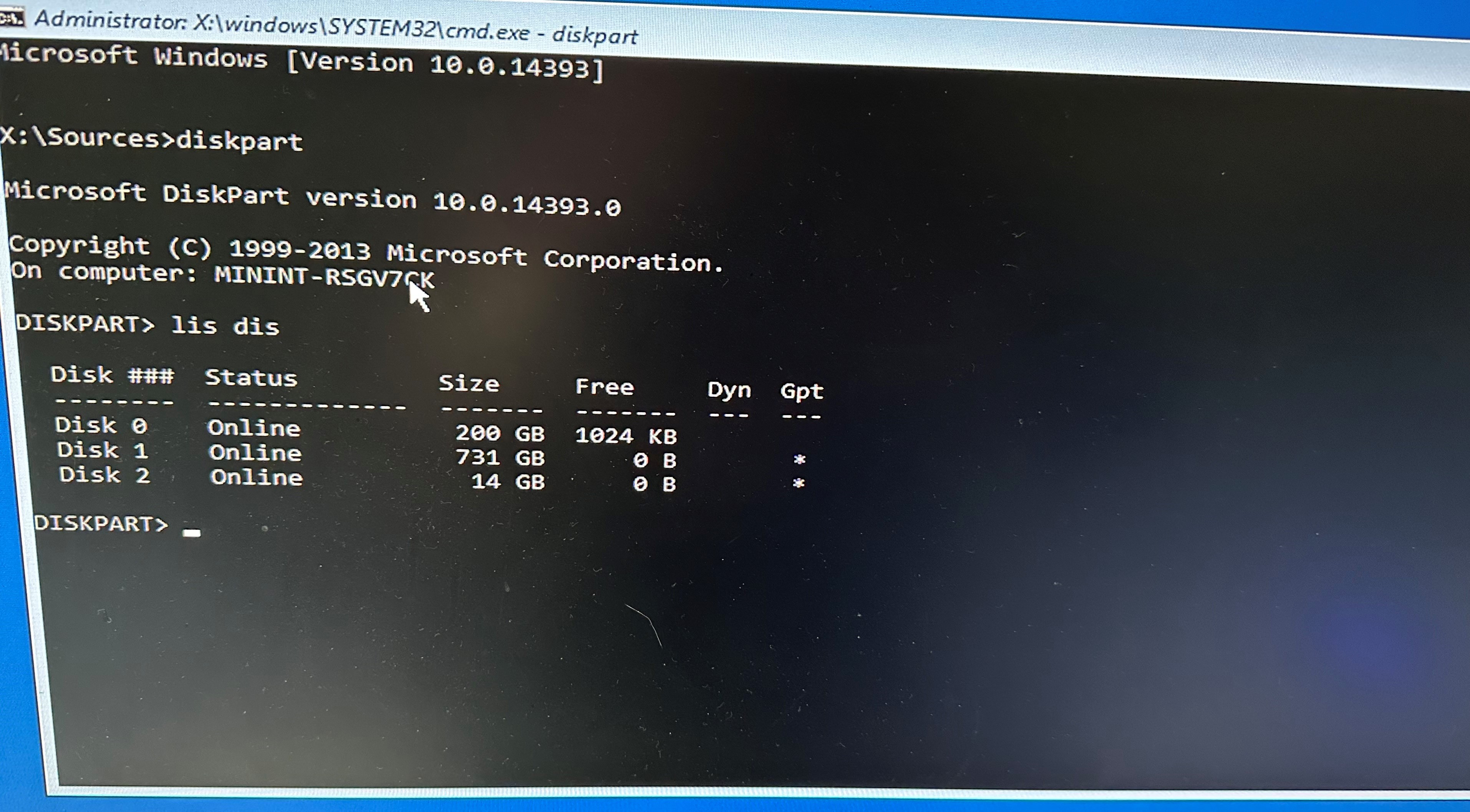

Do you have a bootable flash drive with the Windows installation files on it?
Boot that and go into Repair This Computer.
Choose the commandline option.

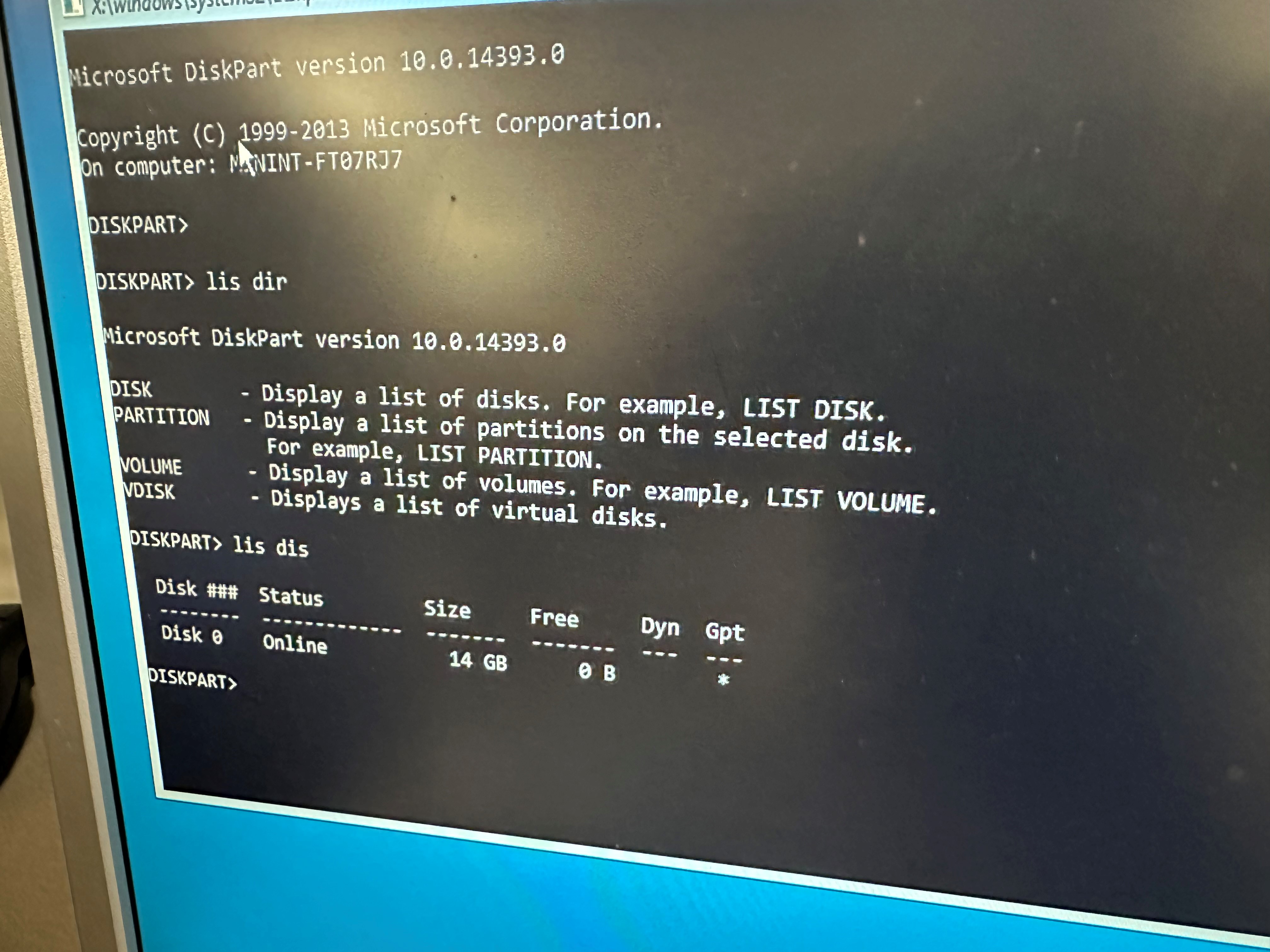

Start DiskPart
Lis Dis
Post the list.
You may need to install the F6 driver for the RAID controller in order to get the RAID 1 drive to show up.
Ok, the drive is not listed. As you suggested, I'll look into installing the F6 driver for the RAID controller.

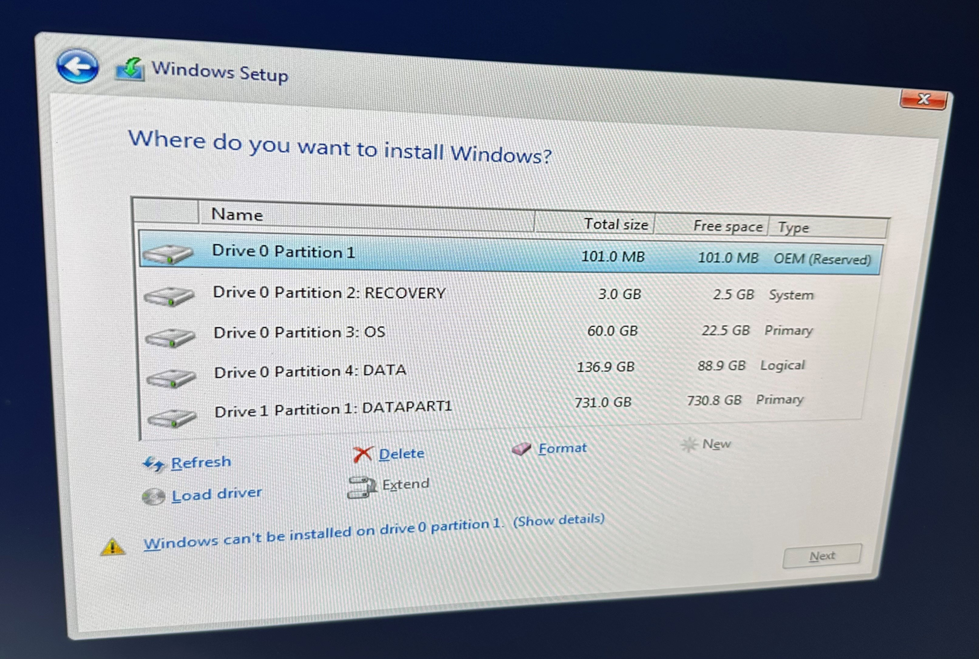

I can now see the drives if I boot the USB drive with Windows. Also, if I run “Diskpart”, it now lists the disks—still, the same message when I try to boot up the system.

you have a recovery partition - you could use that - if you have a good backup
