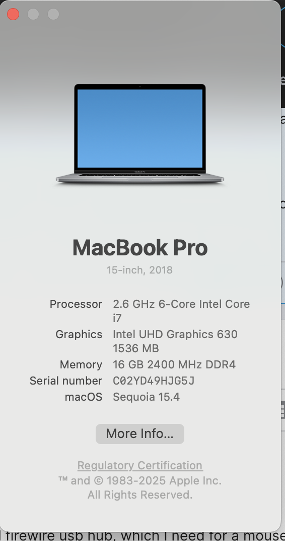

Avatar of James HancockJames Hancock🇺🇸
The Macbook is pretty thin. 15 " screen. I keep the lid open…
It heats most when I plug in an external firewire usb hub, which I need for a mouse.
It does not have a USB  port, just firewire.
I don't use a mouse now, but it would be nice for games. Games heat it lots, and the screen pixels splatter sometimes. I power it down when I go away to do something. It has pitiful ventilation.

Avatar of serialbandserialband🇺🇦

I doubt that the monitor is damaged at all.  The “pixel shimmering” is generally caused by faulty data in overheated chips, causing data signal corruption. If the chip heats beyond that threshold, the graphics should completely freeze up.
If it didn't heat enough to melt the graphics chip or the packaging, then you only shortened the lifespan of the GPU by a little bit.  It should still mostly last well beyond your typical owner usage lifespan.
Have you opened the system and cleaned out the dust?
