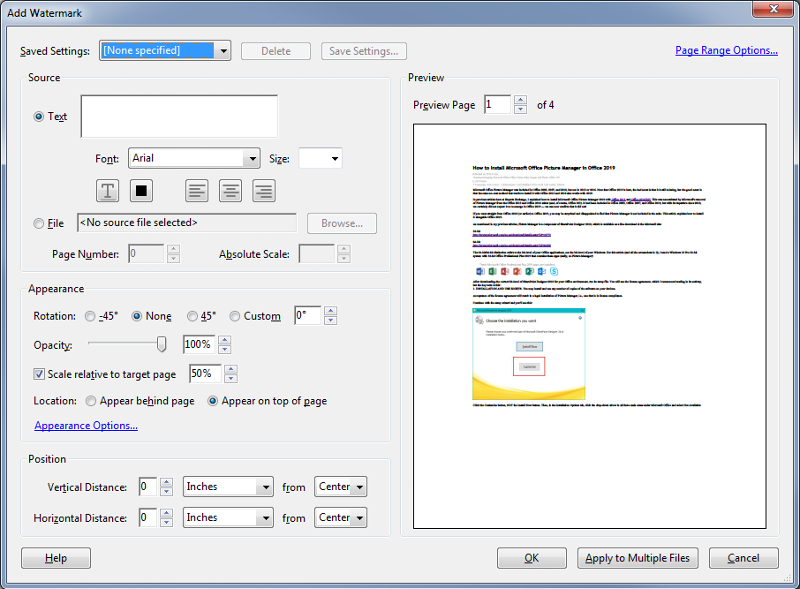

Step3 - Add Watermark dialog
Tick File radio button.
Click Browse button and navigate to the color bar file created in Steps 1 and 2.
Un-tick the Scale relative to target page (not needed since you made the bar the size that you want).
Click OK button.
