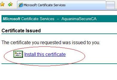

I was reviewing the process to create the certificate, and as you know in Microsoft Certificate Services this is done through a website (http://myserver/certsrv). At the end of the process when the certificate is created it just gives me a link that says "install certificate". What I have been doing is clicking on that link as the only way to install the new certificate.

Avatar of camilorgpcamilorgp🇺🇸
Unfortunately this link only allows a regular click. The right click has no effect whatsoever over this link, meaning that a pop up menu doesn't come up when I right click it. Please check the link Im talking about in the image attached.
