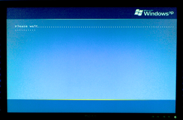

My laptop has started showing a Windowx XP blue screen with Please wait.......... before the login screen appears how can I fix this
I have a Dell Lattitude D420 notebook running Windows XP Profession service pack 2 with Office 2007.  Lately when starting up I have been getting a Windows XP blue screen appearing with the words Please wait followed by a series of dots progressing across and down the screen.  Sometimes this only last a few dots and sometimes it gets to three rows or so.
I have seen some comments on this but no definative comments, but it would seem something is going on in the background.  Outlook doesn't seem to be shutting down completely when exiting it before shutting down and I am wondering if this is the background activity causing the blue screen to show up.

your machien is running a chkdsk on startup each time it starts
http://windowsitpro.com/article/articleid/13739/how-can-i-stop-chkdsk-at-boot-time-from-checking-volume-x.html
should resolve it

could well be wrong as you would usually see chkdsk prompt but if it is automating out teh registry you may see a screen like this so worth checking, apologies if its a wild goose chase ;o)

Ok sorry took so long to get back I have checjked waht the setting is and it is ...autocheck autochk *...so I would need to change to ..autocheck autochk /k:c *
This would stop the system checking the c drive for dirty bits so would I have to do this mannually periodically?
Avatar of K3eK3e🇦🇺
since my last comment I have changed the autocheck value, shutdown and started up the notebook again.  Surprisingly I still get the blue screen.  Any other thoughts?

delete the autochk value altogether
you can still perform a chkdsk command yourself from teh dos prompt or recovery console

hmm no this is starting to look more complicated than it initially sounded do you have you roriginal disks we can use to get to teh recovery console.
i think if you can then bott to recover console and run chkdsk /r to see if anything is going wrong with your disk, might actuallyjust need that to clear it. if that doesnt succeed we will then run fixmbr from the console to see if tehre is an error in teh boot record and the failing everythign else we will try a repair install

hey slam ...well it would seem you have nailed it.  I installed the recovery console, ran chkdsk /r and there were errors which were fixed.  They were not identified, but haven't had the blue screen again yet.  Also ran defrag.
