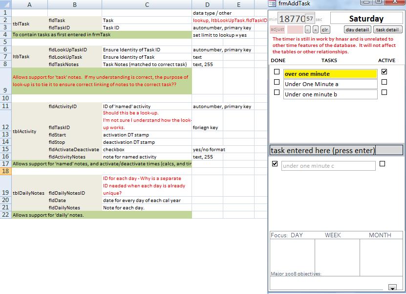

Avatar of verpitverpit🇺🇸
SB9...  I wrote up your recommendations.  Any notes you can put in for the why and how are greatly appreciated www.dropio.com/tasksdb.
pictures of what sb9's recommendation.  Please make any further comments if you can to help me understand the reasoning behind your proposed picture.  www.dropio.com/tasksdb picture
picture and spread both there...   just picture here
Avatar of SheilsSheils🇦🇺
you will also need
fldComplete  fldActive in tblActivity
set the datatype as yes/no and format them as on/off

The Activity table (tblActivity) I am proposing keeps a history of all the activities. What task was performed, when did it start and when did it stop.

Here is my current understanding of your redesign.  I'm confused about the lookup tables?
The task fldTask in tblTask looks up to fldTaskID in ltbTask
This is just to make sure that there is no typo in the fldtask in tbltask which will then generate false results in your query
I'm still confused.  The way it looks to me in the screenshot, entering new tasks in frmAddTask would force a lookup?  I want the user of the database to simply type "get coffee" where that does not require a lookup.  Is this still possible?
lookup confusion
lookup confusion... updated screenshot
You can allow the use to type get coffee an it will create a new task in the lookup if it does not exist. It is good practice to have a message box that ask the user if the really want to create a new task. The reason for this is to avoid "get coffee" and "got coffee" becoming two different tasks. Your database needs to be user friend but you still need to exert some control over what the user does and have checks and balances to limit junk data entry.
Remember junk information entry = junk information output.
Comments on your table properties
line 9: yes you are correct
line 12: yes it will lookup to ltbTask. Just select lookup as the data type and follow the prompt. It is as easy as ABC.
I note that the field on line 12 will also form a one-many relationship with tblTask.fldTask
line 19: using ID in table is just good practice but in this case I think you are right. Just make the date a primary key.
Note another advantage of lookup table is the ability to change the name of a task so that the change occur in the whole database.
For example:
tblTask.fldTask only stores the number found in ltbTask.fldLookUpTaskID. What the user sees is the text from ltbTask.fldLookUpTask
If one day you want to start calling "get coffee" as "coffee break" all you have to to is edit "get coffee" in ltbTask.fldLookUpTask and all the "get coffee" in tblTask will automatically change.

SB9....  Thanks again, what do you think here?
"Your pick me items looks a lot like notes. Why not just throw them into the daily notes?"
 I removed the tblOpportunity (which was basically a type of todo list.  I think I have corrected this with task categories.
 I don't think I quite completely understand the tables just yet but am getting there.  This will be necessary before moving on to relationships.  Please check out the current design with tblOpportunity removed if you can.  I think the best way to actually see this initially along with my other questions, is in the tables_and_fields.rtf doc found at www.dropio.com/tasksdb along with the latest mdb of the tables (version d).  It's got everything in a concise list with descriptions that is easy to read.  I need help with my understanding of the table descriptons (in black) and the questions and other items (in red)
 Of particular mention, are some duplicate fields which will make renaming them using RickFisher's renaming tool much more difficult (assuming it were ever necessary following this superb design!).  For this reason, I would like to have distinctly different field names even if the fields reside in different tables.
 Once I understand the table and get that right, I can move on to relationships.  Thank you again for any comments you can make about the notes in tables_and_fields.rtf and the current database found there.
understood about moving on...  I agree.  Except for the fields with duplicate names.  I don't like duplicate names for the fields.  Bad Idea..  I have not seen your notes here but my hope is that you made some about that because until I understand at least why a field MUST be a duplicate (and there are only 2 with that problem, then I have to figure that out first).
If anyone else wants to chime in here and help me finalize my descriptions of each table in the tables-and-fields.rtf file found at www.dropio.com/tasksdb , I would greatly appreciate it.

sb9 and badotz...  Thanks for chiming in on the duplicate thing.  I just posted a new rtf file.  Please keep in rtf if possible.  Can you both take a look a the duplicates in v2a of the doc?  I tried to note them in red.
Thanks again and hopefully, I can begin reading and creating the relationships soon.  You are both a tremendous help!
Have I got as much support as possible for future growth given the extent of it's currently stated purpose, in the design of the tables?  The reason I ask is because in the original database also posted at www.dropio.com/tasksdb, tblAllTasksEachActivity appears to be some kind of sub_field with +/- to the left of each row.

I am lost now for sure!  So badotz, with your plan, what I do not understand is that the notes are all in one table.  Not bad.
What about the comment from SB9? "If you go through the discussions you will find that verpit wants the task to activate and deactivate everyday and be discontinued at the end of the day. In other words they are not all tasks in the true sense of the word, a lot of them are more like activities. The layout I proposed provides a database that can handle such complexity"
Does your plan follow my purpose:
  1. Record start and stop times of individual tasks (up to several times daily for each).
2. Keep various "categories" of tasks
3. Provide detail at the level of day, task, and stated activity.
4. (added) Provide flags, and tagging for tasks.
Allow support for main form in the old database housed at www.dropio.com/tasksdb.
What do you think?
You are certainly right sb9.  I certainly do want to move on and would have had there not been some sense in at least considering the alternative objective being proposed.
sb9s proposal
pros:
sb9 'seems' to have a clearer sense of my objectives.
naming 'convention' seems to make sence
cons: can't get a clear picture of what the tables do without designing relationships first.
badotz:
pros:
database seems to make more sense to the layman, names appear clearer but so does placing fld and tbl in front
cons:
his understanding seems not quite right
The last con is the very reason we can't move forward and I have no template for how to get on the same page.  I'll start with a simplified purpose broken into examples, and then attempt to answer badotz question.

I'd like to get a list of tables and fields with clear descriptions of what each does to understand either proposal better, if that would be OK?  Thank you both for putting so much effort into it.  If they could be in the same post, even better.

Modify your exiting database to the following
ltbCategory
CategoryID            AutoNumber (PK)
Category                Text
Noteid                     Long (FK to tblNotes)
ltbTask
Taskid                    AutoNumber (PK)
task                         Text
NoteID                    Long (FK to tblNotes)
CategoryID            Long (FK to tblCategory)
ltbActivity
Activityid                    AutoNumber (PK)
Activity                       text
tblNotes
Noteid                  AutoNumber (PK)
Dated                   Date/Time
note                      Text
tblActivity
id                            AutoNumber (PK)
Taskid                   Long, Index, required=no (FK to "ltbTask")
started                   Date/Time
stopped                 Date/Time
Activeid                  Long (FK to tbl ltbActivity)
Then set the relationships PK-FK. You will notice that FKs have the same names as PKs in other tables. That's to facilitate the setting up of the relationship. It is a piece of cake.

As I understand things now:
1. Tasks are engaged in every day - yes and several times daily
2. Tasks can have Categories - yes
     a. Categories group tasks - yes
3. Tasks can have Activities - no, notes can be named by the 'activity' they represent.
    a. Activities are individual processes that apply to a single task - no
 4. Tasks can have notes - yes
5. Notes can exist without a task - notes can exist for the day, task, or named activity
1. Does a task expire at the end of the day? - no never, only activate/deactivate
2. How is a task terminated? - it isn't, it is merely deactivated
 3. If a task is not completed by the end of the day, is it recreated the next (business) day? - yes, every time you enter a task, it is recreated (that day or another day)
4. What is the purpose of the category? - to define groups of tasks
 5. Is a task considered closed when all of its activities are closed? - A task does not have "activities".
6. If an activity is not completed by the end of the day, is it recreated the next (business) day? - no activities with respect to activate/deactivate, only tasks.
 7. There is no "start_date" or "end_date" for tasks. Are they required? only activate/deactivate

Long I do not understand as I use 2007 and have no such option.  default is text 255 which is what I am using for non-date fields.  FK?  no idea what that is.
sb9 redesign #2 posted at www.dropio.com/tasksdb
That's a good start.
FK is short for foriegn key. You will not find this term specified anywhere within access. It just means that this is the field that is going to form a relationship with the primary key (PK) of another table.
Long is short for long integer. When you set the data type of a field to number you get a choice of several field size under the field property eg byte, integer, long integer,single, double,decimal (you can see all these in the design view of the table).
However you did not see them because you had set these field type to text. That's probable because you think that they are going to hold texts. They are not going to hold text eventhough you will see text in them. They will store numbers but display text from another table. You are probably scratching you head by now and wondering how is this going to work. Don't worry, you are only three steps from finding out. (step 1: set relationship, step 2: set the lookup, step 3: insert some test data and see it work like a charm.)
Now for Step 1: Relationship
I have already change all the FK fields to number, long integer. use the one I have posted below for this step.
 I notice that you have put a couple of table in the relationship box but failed to set the relationship. I don't no if you tried but even if you did it would have not worked becuase your FKs where set to text. Now it will work
All you have to do is click on the FK and drag it to the PK. You will notice that the FK has the same name as the PK so there should be no confusion as to what goes with what.
Basically every plain text field with a name end with ID (eg Taskid,Noteid) will link with a bold text field having exactly the same name in another table.
Post the db back once you have done that or let me know if you have any problem getting it done.

Sb9, Can you post your latest database? I''ll take it and draw the relationships per your specifications.  Thanks again badotz for all your help and I think I will go with the naming 'convention' until I become an expert like you.
I'm setting relationships and simply clicking ok on the box shown.  I am using v2007 and can help you find it if needed.
OKee..  Thanks again SB9 for your effort.  I have posted the updated version f.  It incorporates your latest table design which makes use of some of badotz ideas with your relationship links and your naming convention.  I see how the field names make sense now and I am sorry I had such a hard time moving on.
To give you some background.  It was previously suggested that we go with a certain table design and changed later after significant coding etc.  We came to find out during the middle of timer work by another part that the table didn't quite support what I was trying to accomplish.  I just need to make sure I avoid this collapse in the future with a well thought out design.  That was the reason for requesting the definitions of each table which is still not fully understood.  Your efforts have been tremendous and I really appreciate it.   I'd like to have a nice description next to each table for my own reference if possible but it does not have to happen now.
Thanks for your input.  I think I have probably made some mistakes but it's uploaded.
sb9..  what do you think of the latest?  I think the relationships are correct but still need your input.

Well if all you wanted was a table design then its done. Some adjustment are required with the propoerties of some FKs and you can use the fldTaskID in ltbTask as a guide.
If you are going to do more work with someonelese they will easily understand the table description. It is self explainatory. That's the beauty of naming convention. They tell you a lot about what the object are for and gives you an idea of what the designer intended to use the object for. For example the fact that we have named some of the tables ltbXYZ will tell everybody that these tables will store data that other tables will be displaying. Their name of these tables tells everyone what data these ltb are storing. The fact that we've called the PK fldXYZid tells everyone that they are linked to fldXYZ in ltbXYZ and that they should display fldXYZ from ltbXYZ.
About holding the bag. You are always going to be left holding the bag unless you contract someone to construct and maintain your database.
If I was in your position I would construct something simpler that I can full understand. Then add the bells and whistle as I grow in experience. In fact that's exactly what I did with my first databases that consisted of only tables, forms,queries and macros. There was no naming conventions (which was a mistake) or VBAs.

Sb9 - definitions would still help me a great deal.  Here are two messages regarding that issue.  The first is from me and the second is a response to me (thread here).
from me: The tables are the work of sb9 at the end of this related thread.  It is his design.  I was trying to get a good descriptions of each field before he left but was unable to.  According to tblActivity, it does look like fldStarted would give you the most recent activity for a given task.  That certainly seems logical.  You can see a text file of each field also at www.dropio.com/tasksdb.  Thanks again for your effort.
to me:  verpit, even if someone else designed the tables, it's your data and it's vital that you have a clear understanding of what each field means before you do any further development work on your database.
Thank you very much for any further explanations you can provide in the new database field descriptions.
