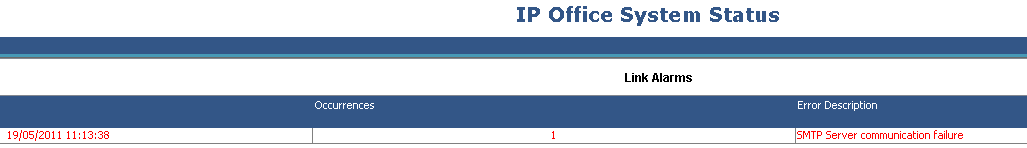

I need my Avaya IP office Β to forward the voice mail to email, all is setup with the right config details, yet it does not send and when i verify the status on the IP Office System Status it mentions: SMTP communication failure as shown on the image below:
Β User generated image
ANY IDEAS? Any idea on how i can troubleshoot this? Its the only device on my network that has problems emailing...

Several possibilities come to mind....
1) Avaya has no network route to the smtp server (seperate vlan or network possibly?..possibley a DNS issue trying to resolve the hostname of the mail server)
2) Avaya has the wrong credentials or is not using credentials to send mail and it is required
3) The IP address is not in a range that is allowed to connect to the smtp server.
Avatar of Ron MalmsteadRon MalmsteadπŸ‡ΊπŸ‡Έ
"communication failure".... sounds like an error that would occur if it was able to connect to the server initially, but the server rejected the mail or connection and closed the connection prematurely.

Are any errors showing on the mail server?
. . . agree with both comments above. You need to see if the Avaya can actually reach the email server. Don't know enough about Avaya to know if there's a CLI to be able to check connectivity. But you can trace the connection from the email server and see if you ever see an attempt by the Avaya to connect. Use wireshark or tcpdump (if for some odd reason you are using a unix based email server. Ha!)

The SMTP server is configured on the IP Office Manager 8.0 (14) and the embedded voicemail is being used. As mentioned before this is the only device that can't send out alerts i have other devices on the network with the exact same configuration, the account that is being used to authenticate is correct as well and is the same used on the other devices - Β It also on the exact same range as everything else on the network.
I'm using a hosted exchange solution so it's an external IP.
the only thing i could think of would be the routing...i cant figure out the section where one configures the gateway. There is a IP address section , a IP Mask and then a Primary Trans IP Address, would that be the same? Would Primary Trans IP Address be the default gateway?

Will give that a try and will revert, thanks...
Avatar of YOlanie_VisserYOlanie_VisserπŸ‡²πŸ‡¨
Worked wonders! thank you so much for the help!
