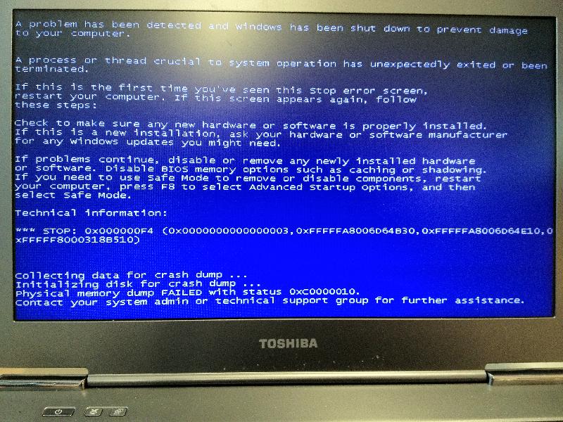

Hi People,
Does anyone know what happened to my laptop please ?
I'm using Windows 7 Professional 64 bit on my Toshiba Z830 laptop with 128 GB SSD drive, and I have no Anti Virus installed in it.
When idle for couple of period of time, it turns into BSoD mode by itself ?
Any kind of help and assistance would be greatly appreciated.
Thanks.

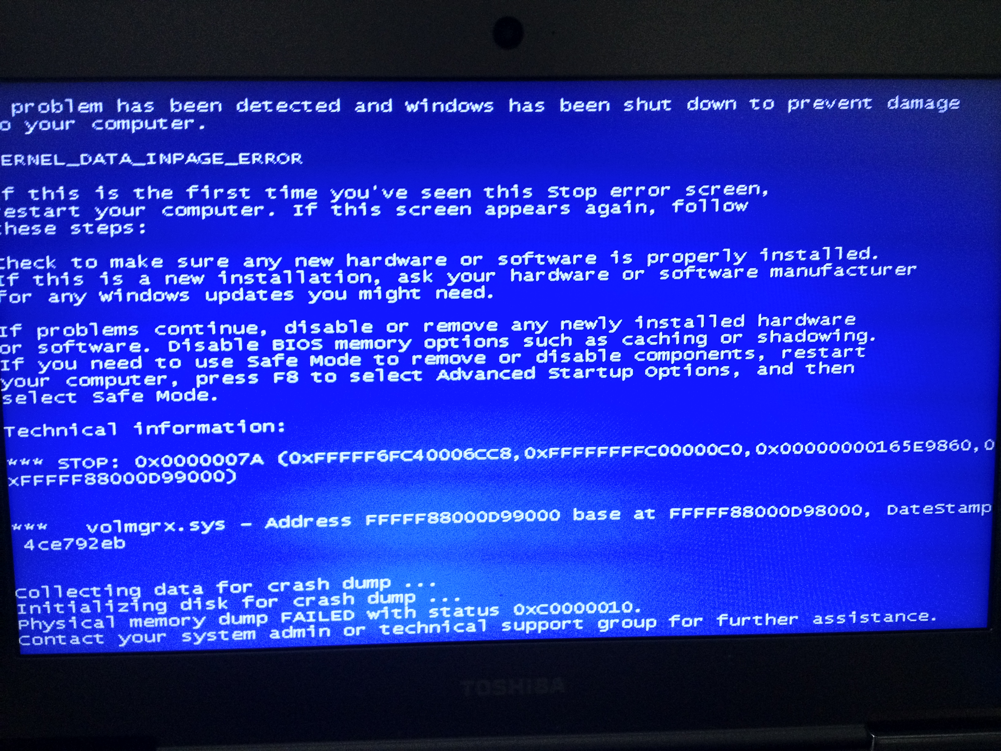

and just now I had it once again while I left my laptop on overnight for downloading.
This time it is difference error ?

Avatar of Senior EngineerSenior Engineer🇦🇺
And somehow it Blue Screen-ed again but with different error message.
