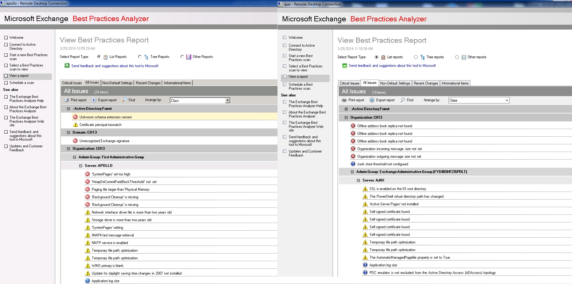

Avatar of cmp119cmp119🇺🇸
I just ran BPA on Exchange 2003 once again, and it found some issues:
1.  Active Directory Forest:  Unknown Schema Extension are from unknown version:  Schema version detected is:  14734.
2.  Certificate principal mismatch:  https://rcsch13.com does not appear to match host address.  Host address:  rcsch13.com. Principal: O=mail.rcsch13.com, OU = Domain Control Validated, CN = mail.rcsch13.com
3.  Domain: ch13:  Unrecognized Exchange Signature:  Active directory domain "ch13" has an unrecognized exchange signature:  Current Domain Prep version 13040.
I believe items #1 and #3 might not be an issue since it may consider them as foreign since its a newer Exchange 2010 server, SP-3 that extended the schema during installation.  I do not think the certificate issue would pose mail flow problems.
When I installed Exchange 2010, I initiated the following commands beforehand:
setup.com /preparelegacyexchangepermissions
setup.com /prepareschema
Extending the schema initially failed, but was able to complete it successfully after installing RSAT via command "install-windowsfeature RSAT -ADD".
I then ran the exchange 2010 setup of which installed without error.  My understanding is that there was no need to worry about running these commands since installing Exchange 2010 will automatically take care of it.
Anyway, Exchange 2003 BPA did show (5) other error message for:
Admin Group:  First Administrative Group:
1.  System Pages too high:  current value 798720
2.  HeapDeCommitFreeBlock Threshold not set.
3.  Paging file larger than physical memory.
4.  Background Cleanup is missing.
5.  Background Cleanup is missing.
I attached a screen shot of the BPA results for each Exchange server.  Left side (Apollo) is the exchange 2003 server, right side (Ajax) is for exchange 2010.   I also attached ESM for Apollo.
There is nothing in what you have posted that leads to concern. The first three errors are all to be expected, so can be ignored.
Do check that you do not have restrictions on the SMTP virtual server. I am sure that this problem is somewhere with the SMTP virtual server configuration - either away from default configuration, restriction etc. Something isn't right there.
Simon.
