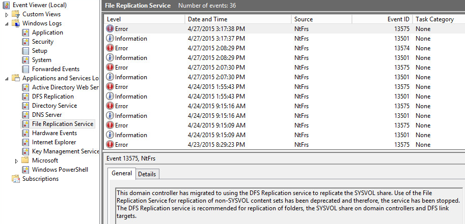

Also, I think it is odd that the File Replication (ntfrs) is constantly starting/stopping stating that the DFSR is taking over for it. The File Replication service is disabled so it seems odd that it would be trying to start.
This isn't normal, is it?
Avatar of pjampjam🇺🇸
File Replication Service should be disabled.  It is no longer used on the DC since it now uses DFS Replication or DFSR.
Not sure when it stopped, possibly after 2003.
gotta love all those confusing acronyms
