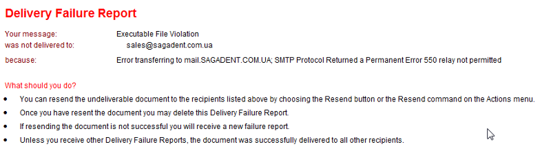

Avatar of Laurent .Laurent .🇻🇳
Hi Steve,
I mean the email address in the TO field of the NDR(see attachement), the one the server used to send all NDR.
Avatar of Steve KnightSteve Knight🇬🇧
Still confused, sorry, what you show is normal?
A NDR  will show as coming from "Mail router" and if you looked at the from address it would be yours.
The To address is the one you were trying to send to.
Are you getting junk NDR's i.e. ones you haven't sent the original mail, in which case need to track down whether it is coming from your network or server or junk mail sent from your domain name by others in which case implement SPF in DNS will help a lot.
Hi Steve,
Thanks for your feedback.
I'm a little bit confused myself.
The NDR is send FROM Postmaster@myhomedomain.com  TO helpdesk@myotherhomedomain.com
Here after the full SMTP message.
The more i see it the more  i'm thinking about spam to the mailbox postmaster.
Since I'm not really familiar with Domino, and wonder if the domino server would not have somewhere a setting that send a copy of the NDR to the mailbox helpdesk@myotherhomedomain.com.
Both myhomedomain.com and myotherhomedomain.com are domains that belong to us.
Both domain have their own home hosted domino server.
mysmtpgateway.myotherhomedomain.com is the host link to the primary incoming MX record for both domains.
helpdesk@myotherhomedomain.com is barely used today, no trace of any documents sent to the "@sagadent.com.ua" which confirmed your theory.
I also discover that the postmaster@myhomedomain.com is an internet address attach to a lotus admin account (not really smart from those who installed domino).
As immediate action i did:
-change postmaster email address on that admin account so that it can't be identify as valid sender.
-add domain sagadent.com.ua to my blacklist on the mysmtpgateway Symantec Messaging Gateway.
I will monitor the traffic for the next day and see if i still received those NDR.
Thank you very much for help.
