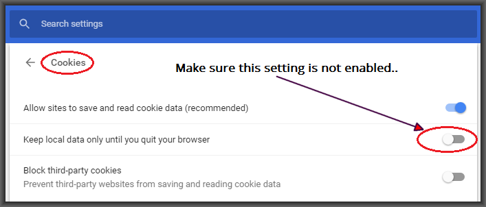

Avatar of Andrew LeniartAndrew Leniart🇦🇺
Hi Basem,
In Chrome's Cookie Settings, make sure "Keep local data only until you quit your browser" setting is disabled.  See below.
Hope that helps.
Avatar of Basem KhawajaBasem Khawaja🇺🇸
Andrew
How do I access cookie settings?

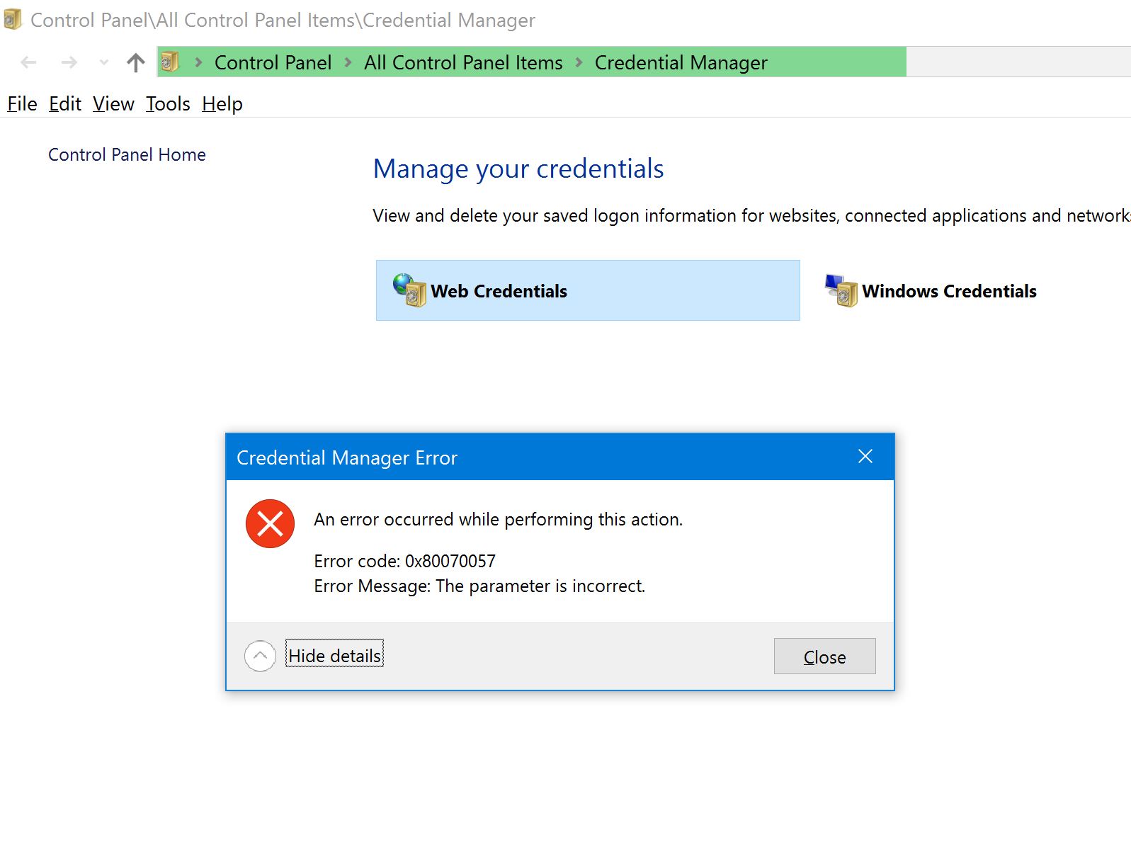

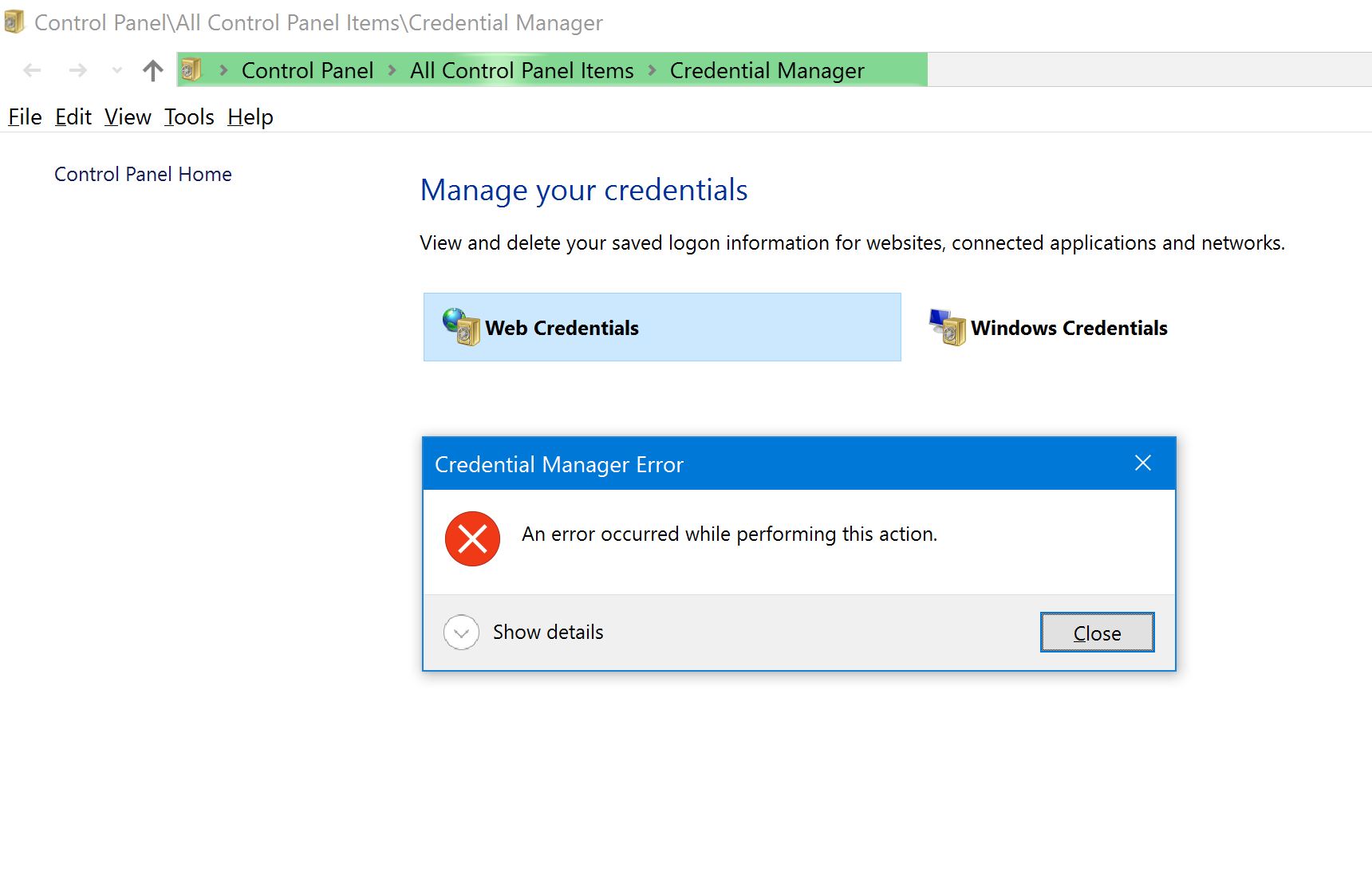

Expert Comment by:Limited Member
When I went to the credentials manager. I got an error message saying error occurred while performing this task and the web credentials were highlighted . I do see windows credentials and able to click on it but the website in question or EE is not listed there.
Avatar of JohnJohn🇨🇦
That should not be.
First I assume you got into Control Panel using an administrator account.
Second, you have other problems it appears.  Try running both of the following
System File Checker:
Open cmd.exe with Run as Administrator and run SFC /SCANNOW.
Allow to complete, restart or, preferably, shut down the computer and then start up again.
Test to see if the problem has been corrected.
DISM:
Open cmd.exe with Run as Administrator.
DISM.exe /Online /Cleanup-Image /Restorehealth (takes 15 - 20 minutes).
Restart the computer and test.
Hi Basem,
Just type chrome://settings/content/cookies into Chrome's address bar and hit enter.  That will take you to the page I've shown above.
Andrew
It was already disabled

That your Credential Manager appears broken, you need to try the corrective suggestions above.

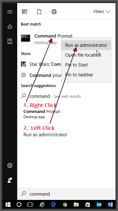

Can u tell me how do I run the cmd.exe as an administrator?
Basem,
Can you please double check one thing for me?
Are you certain you ran the cmd.exe as administrator? I know your Windows account may have administrator privileges, but you also need to right click and select "Run as administrator" as well.  If you didn't do that, then that would explain the following error you said you got..
error 740 when I tried to run the test. Elevated permission required to run DISM
To open a command prompt with Administrator privileges
1. Right Click over Command Prompt - Desktop app
2. Left Click "Run as administrator"
3. Now try running the commands suggested by >Limited Member< above..
Did you get an "Elevated permission required to run DISM" error this time?

Go to the Search button, type in cmd.exe and at the top you see Command Prompt. Right Click on that and select Run as Administrator. Good luck.

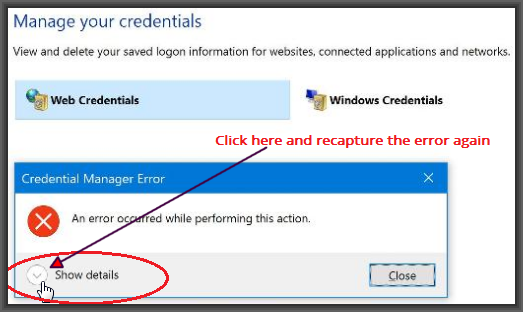

the web credentials error message says error code 0x80070057 error message the parameter is incorrect
Hi Basem,
You have a corrupt Credentials Manager, which also relates to Microsoft Edge.  (Even though you are using Chrome)
Hang about and I'll prepare some step by step instructions for you on how to repair the error.

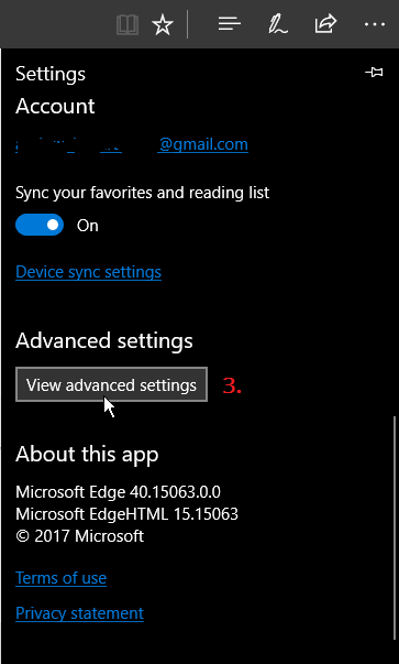

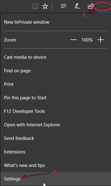

Basem,

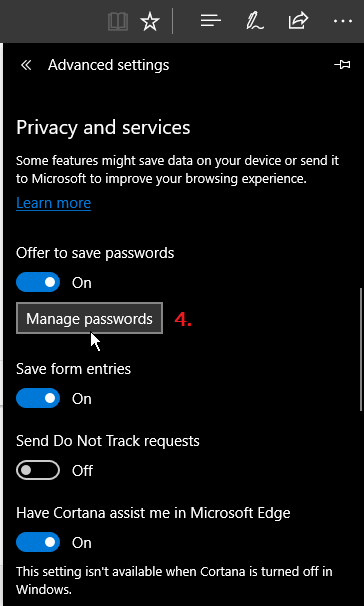

Please complete the following steps;
1. Open Microsoft Edge browser and click the three . . . dots to the top right of the browser
2. Click Settings
3. Click View advanced settings  (Scroll down if you can't see the View advanced settings option)
4. Click Manage passwords  (Scroll down if you can't see the Manage Passwords settings option)
Now select any entry in there (doesn't matter which one) and click the Save button to save that entry again.
That should over-write the corruption.
Once done, close Microsoft Edge and test Credential Manager again to see if it will open without error.
If it still errors, let me know (confirm it is the same error) and I'll give you another remedy.
Please report back with results when ready.

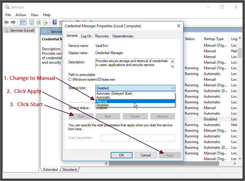

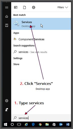

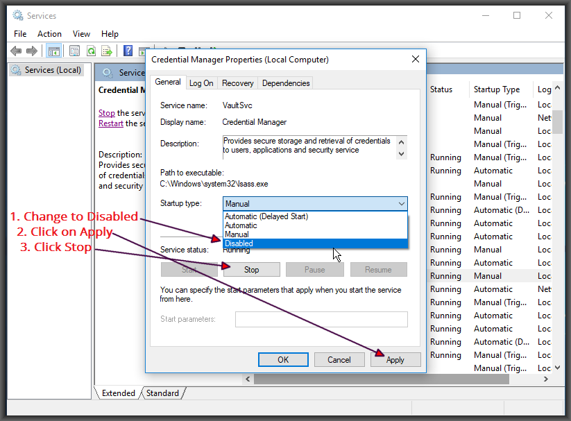

Hi Basem,

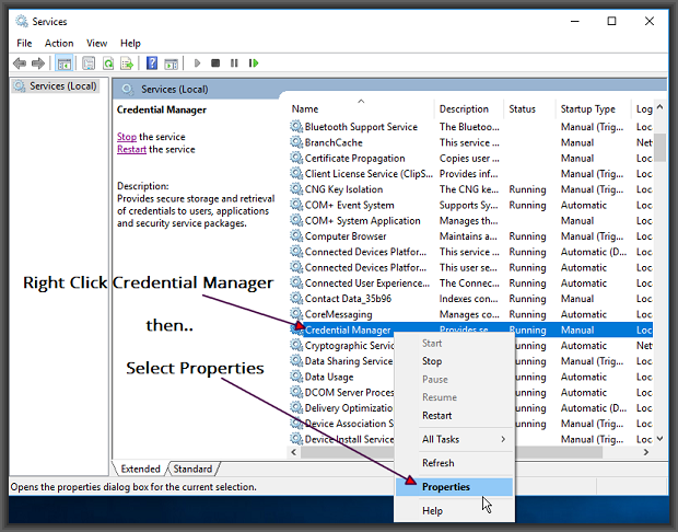

One of the following methods should repair the problem.  We'll start with the least problematic one.
Steps 1.  Press Widows Key and Type "services" to run the Desktop app as shown below
Steps 2.  In the Services window, right click Credential Manager service and then select Properties as shown below
The following steps may not make much sense, but it has worked before so bear with me :)
Steps 3.  Change the Credential Manager service to Disabled, then click Apply, then click Stop to stop the service.
Steps 4.  Now we are going to do the reverse of Steps 3.  Change the Service back to Manual, then click Apply, then click the Start button to start the service again.  Shown in the screen grab below.
Close the Services window and try Credential Manager again.  If it opens without error, then disregard the steps below.

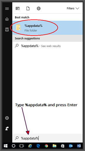

If you are still getting the same error after completing the above steps, then the following process "should" definitely fix it, but you will lose all of your saved credentials in Credential Manager and will need to re-enter them again, either manually or via the browser.
That's why I've left this option as a final last resort to repair the corruption.
Final Option

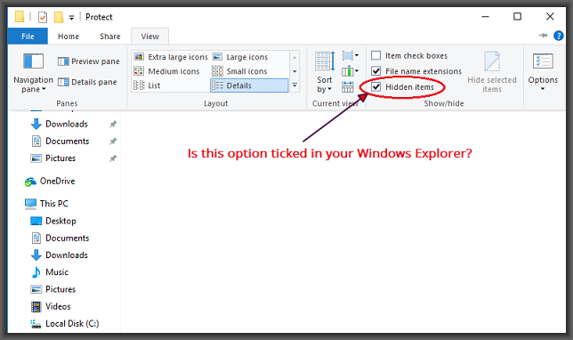

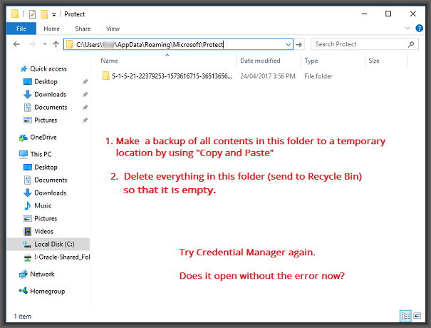

1.  Press your Windows Key and type  %appdata%  then press your Enter Key .. shown below
2.  Windows Explorer will open.  Browse to AppData\Roaming\Microsoft\Protect
3.  Back up all files and/or folder(s) in that directory by copying them to a temporary folder (just in case)
4.  Now delete everything in that folder (Send to Recycle Bin) so that the folder is empty.
Credential Manager should now open without error.  Does it?
Hopefully, that will have finally resolved your Credential Manager corruption problems.
Please confirm if that fixed the "Credential Manager" problem or not.

Step 4 it says make a copy and paste back up into a folder but the folder is empty . how can I backup empty or delete it as u suggested.
Basem,
Delete the folder as suggest, but take a copy of it first for examination later in case it's needed.

Andrew I deleted the contents of the folder but not the actual folder it self it says this folder is empty now yet the error message still there.

Basem, removing the contents of that folder should definitely have repaired the problem with Credential Manager. The fact that it did not points to far more serious issues on your computer than just your browser not being able to remember login credentials between restarts.

Please expand the Details arrow by clicking as shown above and re-upload.
Regards..
Hi Basem,
Thank you for opening up the details tab and reuploading.
Please try the following steps and report on findings.
  1. Press Windows Key + R and type Regedit, then press Enter or click OK
  2. Click Yes to "Do you want to allow this app to make changes to your device?"
  3. Next we will backup the entire Windows Registry in case a mistake is made
First - Backup your Windows Registry
  1. In Regedit, click "File > Export"
  2. Ensure the Export Range is set to All
  3. Give the backup a descriptive name like "Registry Backup" in the File name: box and click the "Save" button - it doesn't matter where you save it to, just remember the location you selected in case it's needed later.
  4. The last step makes a backup of your entire Windows Registry Settings, so any edits or changes made from here on can be reversed by double clicking on the "Registry Backup.reg" file you saved. This is a safeguard in case you make a mistake when changing registry settings.
Second - Check Registry Entry as follows
  1. Navigate to the following location in the Registry Editor
  2. HKEY_LOCAL_MACHINE\SYSTEM\CurrentControlSet\Services\VaultSvc\Parameters
  3. Check the "ServiceDll" entry on the right hand side - it "should" be C:\Windows\System32\vaultsvc.dll
  4. If it is not, make a note of what it currently is, then edit the entry and change it to read exactly as shown above.
  5. Also check to ensure no hidden spaces exist at the start, or end of the above data value. If there are, remove them.
  6. Restart Windows after making changes and then try Credential Manager again to see if the error still exists.
if the registry entry is already as shown above in bold, with no extra words or spacing, report back for additional trouble shooting steps
Thanks..
Basem, something just occurred to me that is worth double checking.
Further to the above, can you confirm that "Hidden items" is ticked to allow you to view hidden files and folders in Windows Explorer?
On the View tab of Windows Explorer, check to see if you have ticks as shown below.  If not, that could explain why the Final Option in this Previous Suggestion did not work.
If it was not, please repeat the Final Option steps in this ID: 42208977 previous suggestion to ensure everything in there is deleted as was suggested before trying Credential Manager again.
If "Hidden items" was already ticked, you can safely ignore this post.
Thanks..

not sure if I mentioned this or not for some reason a couple entries {2} to be exact showed up in it yesterday which I copied the folder and the contents to desktop though before deleting them.
No you forgot, but never mind. I forgot to ask you to check if your hidden files setting was checked in Windows Explorer so that can happen to any of us :)
That's actually very useful information though, because it should have been empty after clearing that folder if Credential Manager is still throwing up an error.

  3. Next, Open Microsoft Edge
  4. Click the Three . . . Dots at top right of Edge
  5. Click Settings
  6. Click View Advanced Settings
  7. Click Manage Passwords
  8. Step by Step instructions for the above steps already given here ID 42208810
  9. Move to 1A. below
1A. Do any entries exist in the Manage Passwords "Web Credentials" section?

  1. Click Start > Run
  2. Type %appdata% and click OK
  3. Browse to "AppData\Roaming\Microsoft\Protect"
Is the "Protect" folder still empty? Contains no folders or files at all ?
If yes and it's still empty, that's all you need to check for now. Just report back detailing all of your findings after the above steps.
If no and folders or files now do exist in there, delete everything in there and then try opening Credential Manager once again.
Still getting the same error?  Again, report back detailing all of your findings.

Did any entries exist in the Manage Passwords "Web Credentials" section of Edge?  YES
Did any entries exist in the Manage Passwords "Windows Credentials" section of Edge? YES
Was the "Protect" folder still empty? Contained no folders or files at all ?YES it is empty. But Can I copy the contents from the backup folder in my desktop and paste it there?
