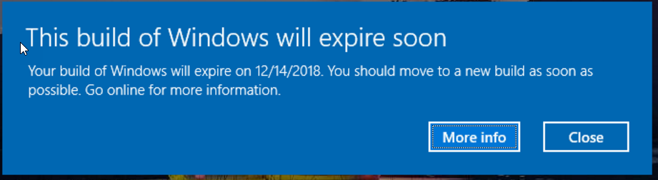

I have at least a couple of computers that are displaying a message a login:
User generated imageNow, the message by itself isn't so concerning (because nothing seems to happen a month after the stated date) but what it may mean indirectly could be more of a problem.  Somewhere I read that this is associated with the Windows Insider Program.  So I've found this seems to be the case and am trying to get the computer out of this state.

User generated imageSo I'd like to understand how this came about and how to fix it.
The tech who set up these computers appears to have ENABLED "Manage preview builds in the Windows Update for Business section of Windows Update in
Local Group Policy Editor / Computer Configuration / Administrative Templates / Windows Components. by mistake - which started all this.
On one computer we were able to set "Manage preview builds" to "Not Configured" but the expiration notice continues.
Then I change it to "Disabled" and it appears that nothing changed with that either.
Nonetheless, the 2nd message above is the most disruptive as I'm not able to set up workstations with this happening in order to accommodate instrumentation, etc.
So, this condition is the most urgent to figure out how to fix.

(a) Keep your insider build current. We (insiders) must do this.
(b) Is this Windows Home?   Gpedit has never been blocked on my insider (or any Pro) build.
Note: The point of (a) was to update your machine and see if the new build fixes your issue.

First: update to the current insider version and see if that fixes the issue.
Try running SFC and DISM from an admin command prompt.
SFC /SCANNOW
dism.exe /online /cleanup-image /restorehealth
Then if that does not work, try reimaging one of the machines to see if that works.
