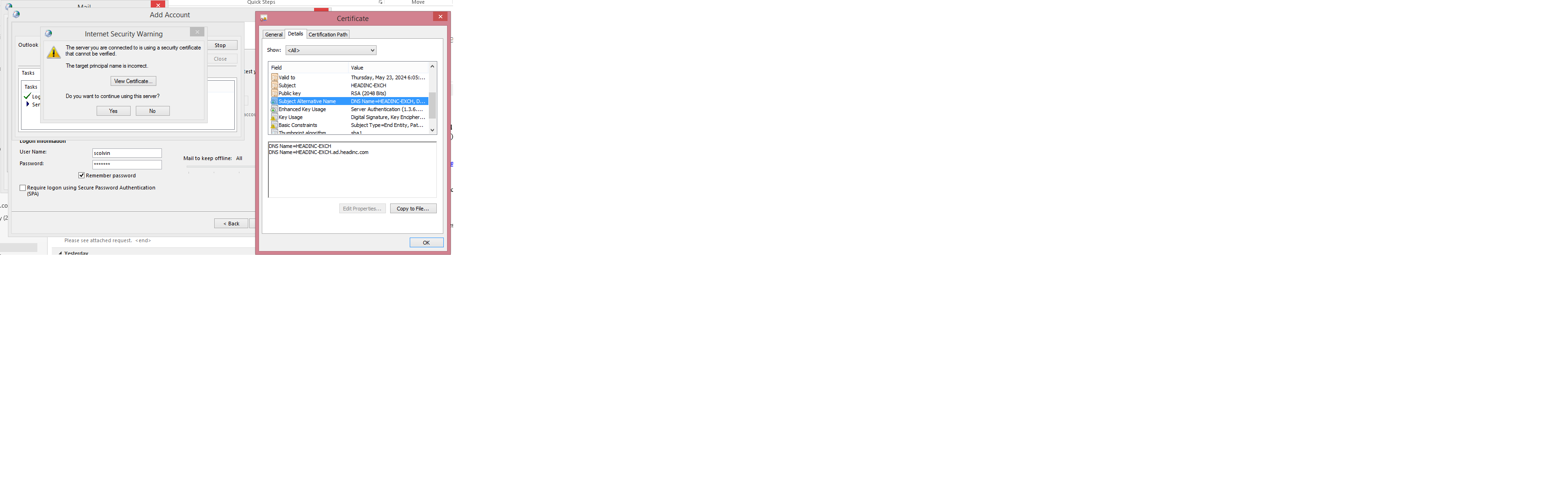

Alright, Sorry for the delay I got a call.
On your server, it seems you did not check IMAP nor POP3 to be accepted on your certificate, hence the error on my attached file.
When you configure outlook select either SSL/TSL both do the same thing the only thing is TLS is the successor of SSL - for outgoing select port 25 or port 465 to encrypt outgoing as well.

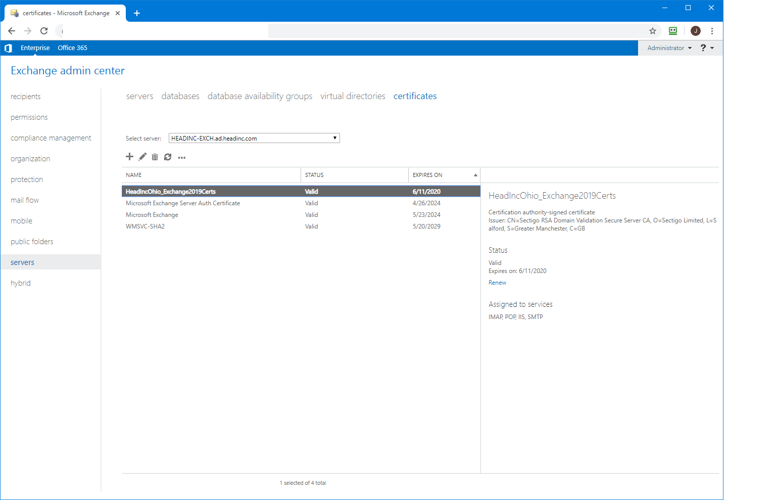

That's what I thought may have been the case as well, but as you can see in my attachment, I have selected IMAP, POP, IIS, and SMTP in that cert. Should I be selecting that somewhere else?
Or do I need to refresh the cert somehow?
Thanks!

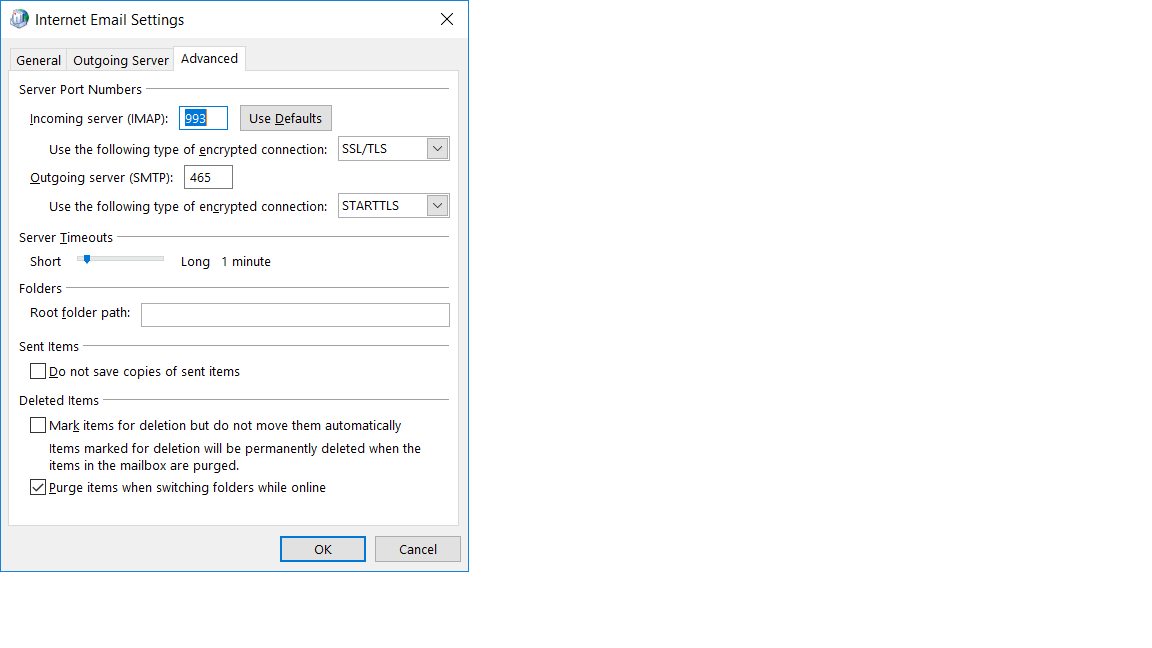

Protocols like SMTP/IMAP/POP3/MAPI will work as long you have listed the domains on your certificates - then you can go ahead and open the ports - 465 SMTP and 993 IMAP and configure outlook.
Look at the image attached.
Hemil was EXTREMELY helpful to this resolution. The guy was fantastic. We spent quite a bit of time troubleshooting and resolving the issue and learning together what was going on. A+ help!
I was able to get it working in either of two configs:
1) IMAP using port 143 via encrypted TLS  + SMTP via port 587 via encrypted TLS
2) IMAP using port 993 via encrypted SSL + SMTP via port via encrypted TLS
