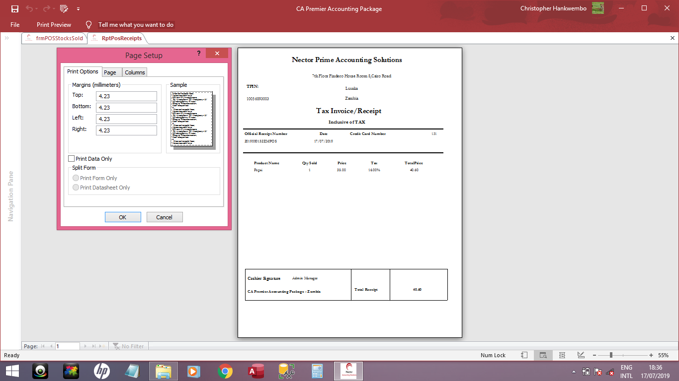

How to set the correct paper margins for a POS printer in Ms Access Design view
We have installed a POS printer called CITIZEN CT-S310II from Japan , now it keep print on A4 no matter what we do , we are able to select the default paper size which is a receipt type but still nothing works , this machine is on MS access 2016 app. Due to this problem it keeping on printing and cutting the document into 7 pages
The problem is on the paper margins, see screen shoots
See how you can help me I will appreciate help from experts

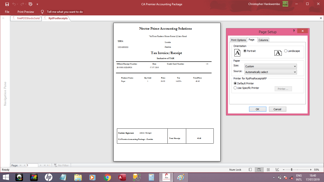

If you don't add the custom paper size from the print server properties nothing will work

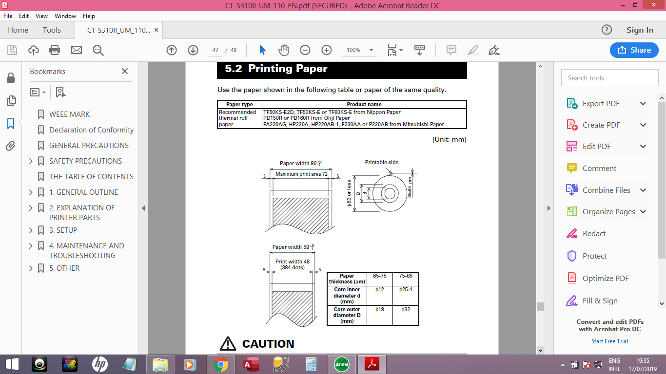

Avatar of Hankwembo Christopher,FCCA,FZICA,CIA,MAAT,B.A.ScHankwembo Christopher,FCCA,FZICA,CIA,MAAT,B.A.Sc๐Ÿ‡ฟ๐Ÿ‡ฒ
The problem here the manual does not state the paper size , how do we know the paper size??????

Measure it with a ruler. ย That's what I do. ย Check the box the paper comes in, it might be written there.
Where is print server properties????????/
Is it different from the screen shoot page set up?????????/

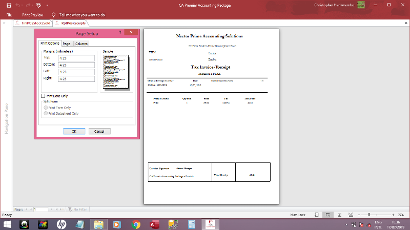

The only information I'm given is as follows:
Top = 0.75 inch
Bottom = 0.75 inch
Left = 0.35 inch
Right = 0.35 inch
Is it only the width which will translate to Left and Right , kindly correct me if I,m wrong!

Avatar of John TsioumprisJohn Tsioumpris๐Ÿ‡ฌ๐Ÿ‡ท
First check if the printer has some kind of utility that takes care of everything...just check printer properties..
If not in the Control Panel->Printers ->just single click one of the printers.... printer server will get visible on the bar above
Your report height/width + margins must equal the measured dimensions.

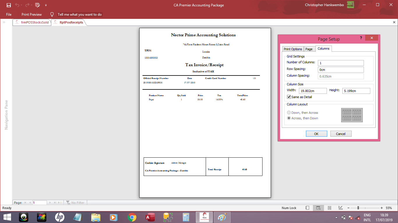

Now here is the screen I failed to interpret it

Thank ย you Daniel , Mark &ย John.
I have matched the report in design mode to the actual receipt, now I'm now waiting to hear from the users.
