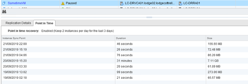

I know.  That is what I have inherited, on the (lengthy) list to change within the time I have available to work on these systems.  Yes it is VMware vSphere replication, with a replication appliance machine running.
I paused the replication as soon as I knew there was an issue so we have 7 earlier replications:
Not an area I have used like I say for recovery but from what i read if I set off recovery I'll end up with a VM with multiple snapshots.  I assume then best would be to clone the machine to try a boot and with NIC offline.

Okay so I assume you don’t know how to restore the earliest replica
It’s good replication has been paused because based on config the earliest replicas can just get erased

I've got time there on Tuesday and from what I can see do it as:
1. recover the most recent entry from DR site.  That should leave me with a VM with previous replications as snapshots
2. copy the VM
3. Boot that up on DR site.  If it does boot, do test reboots, add the missing updates and boot again etc. and try and break it!
4. if not revert to earlier snapshot and try the same again.
If/when it works copy the VM back to main site, clean up and set replication back up.
Does that sound sensible, I suppose step 2 isn't actually necessary but feels better working on a copy.
Steve
Yes, that's correct, but I would restore the oldest replica.

Thank you. Given up now, the recovery process worked perfectly but all 6 replicas held the same issues as did 2 weeks worth of backups. I restored other VM from scratch using same procedure and it was fine so clearly that OS broke itself weeks or months ago.
Time for new OS, app installs and recover data from the backups...
