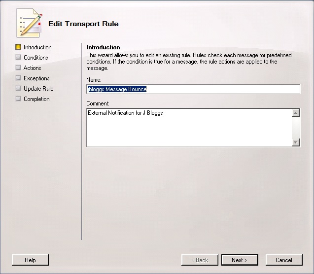

Create the Transport Rule
A Transport Rule now needs to be created to raise an event when the Exchange Organisation delivers a message to the mailbox of the user you want notified.
Using Exchange Management Console, navigate to Organisation Configuration > Hub Transport and then from the action pane on the right hand side select New Transport Rule. This will start the wizard to create a new transport rule.
 transport_rule_01Enter a name for the rule. If you are likely to do this for more than one user then I would suggest entering the mailbox alias or username in the name so that it can be easily identified.  Click Next.
