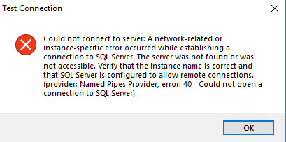

I haven't worked with SQL Server since 2001. Now I'm trying to configure SQL Server Reporting Services. I keep getting an error when I try to create a database in Report Server Configuration Manager or when I try to access the URLs in Web Service URL & Web Portal URL. The following is from ReportingServicesService_2018 log file. Do I need to uninstall SQL Server & SSRS & just start over? Is there a book out there that is for a beginner (which I am after a 17 year break)?  Thank you!
One more thing, the version is 2017. SQL Server Express = 14.0.600.906
library!ReportServer_0-1!665c!12/21/2018-14:14:55:: e ERROR: Throwing Microsoft.ReportingServices.Diagnostics.Utilities.ServerConfigurationErrorException: No DSN present in configuration file, Microsoft.ReportingServices.Diagnostics.Utilities.ServerConfigurationErrorException: The report server has encountered a configuration error. ;
When trying to change database in the database section in SSRS Config manager, I get this - error 40 - could not open a connection to SQL Server. Thank you
Test Connection Error

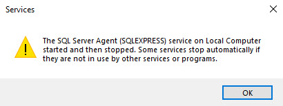

You need to enable the SQL Server instance in Services settings. In windows, go to
(1) Services >> Instance Name >> Right Click >> Start
(2) In the second step, in services, go to SQL Server Agent (related to your instance) >> Right Click >> Start
Now you might be able to connect.
Regards,
Pratik
Author Comment
by:Dolores Hardy
SQL Svr Agent Error
Thank you for your assistance!
I got the attached error on the 2nd step. It doesn't like something in the configuration but I can't figure out what it is. Below is the contents of the RSManagement log.  Any advice/suggestions is very much appreciated. Thank you!

Author Comment
by:Dolores Hardy
Here is another error I see a lot in the logs. How do I create a DSN for SQL Server reporting services to connect to SQL Server. Thank you!
RSPortal!library!RSPortal.exe!1!12/26/2018-14:10:26:: e ERROR: Throwing Microsoft.ReportingServices.Diagnostics.Utilities.ServerConfigurationErrorException: No DSN present in configuration file, Microsoft.ReportingServices.Diagnostics.Utilities.ServerConfigurationErrorException: The report server has encountered a configuration error. ;
LVL 7
Comment
by:Pratik Somaiya
Can you try the following:
Services >> SQL Server Agent >> Right Click >> Properties >> Log On Tab >> Select your method of logging in (enter the credentials if selecting option 2) >> Apply >> Ok >> Again Right Click >> Start
Let me know if this works for you :)
Author Comment
by:Dolores Hardy
I tried both methods & got the same error. I don't know if I should start over & reinstall or keep trying to fix it. I've searched everywhere for the problem. Thank you
LVL 7
Comment
by:Pratik Somaiya
Okay. Let's connect to resolve and then we can decide to go for reinstallation
Author Comment
by:Dolores Hardy
Do you have any advice on where to look for the problem? I did notice the Outbound rule below is in place & set to block in Windows Defender Firewall. Could this be the problem. Thank you
Block network access for R local user accounts in SQL Server instance SQLEXPRESS
Author Comment
by:Dolores Hardy
Tried another account & the connections work. Thank you for your help!
