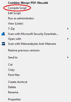

Download the source code for the program, which is attached to this article in a plain text file called Combine-Merge-PDF-files-20140826.ahk. After installing AutoHotkey, it will own the file type AHK, so simply double-click on the downloaded source code file in Windows/File Explorer (or whatever file manager you prefer) to run it. You may also compile the source code into a stand-alone/no-install executable by right-clicking on the source code file and selecting Compile Script:
After compiling it, simply run the EXE file that the compiler created.

Also, using the AutoHotkey compiler on your own computer (which is installed as part of a standard AutoHotkey installation), you can compile the program described in this article (How to Combine-Merge PDF Files in Many Subfolders) into a stand-alone/no-install EXE file which can then be run on your client's machines. Indeed, any AutoHotkey program can be compiled into a stand-alone/no-install EXE file with the AutoHotkey compiler — see the first screenshot in this article. Regards, Joe
