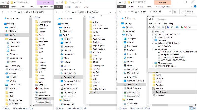

I have a Boot (C:\) and Data (D:\) SSD drives and use 3 year old, used, SATA 1-TB HGST HDD to host the image file. Most would question whether that's wise, but I assure it's best for me and likely for you to.
Most SSDs do not include a DRAM cache, so if you want the through-put advantage of cache, you enable Windows to cache the SSDs to RAM. A small problem does exist in that Windows often forgets to flush it (gets stuck issuing 50,000 clock cycle waits for a write to complete).
Have you ever clicked a quick launch or start icon and nothing happens? Click it again, nothing happens. Click it a 3rd time, you've just clued Windows into "oops I forgot" moment and it clears the cache and opens three instances of what you clicked! Windows doesn't allow me to flush drives manually so . .  I use Mark Russinovich's "sync.exe" from a batch file to flush all three drive, but the HDD doesn't need to - it has 128MB DRAM cache of it's own. My D:\ is an older Intel PCI mount that also has DRAM cache and doesn't allow Windows to cache it.
I should also note that "sync" must be executed off-drive, i.e. you can't flush the drive X is Sync.exe resides on drive x. Another great reason to own a Ram Disk - to host the flusher of all other drives.
I suspect Jackie's problems with the Ram Disk was of her own making, and too little RAM and/or to much set aside for Ram Disk. (I eliminated my pagefile.sys before installing Ram Disk on 16 of my 32 GB of RAM. And if I experience the slow of the century, I'll know I caused it by using not having enough RAM for Windows and the apps I launch.
Now, why do I put my image file on the slowest drive on my system (??) :
Putting it on an SSD, eliminates half of RamDisk's utility. I've tested dozens of scenario's and no matter where it is, if I update anything on my A:\ drive (my RamDisk) - it's driver immediately (<0.25 seconds) starts updating the RamDrive.img file.) When does the updating finish? I can't distinguish a difference using an M.2 NVMe SSD (> 3 GB/sec read and write) and the HGST HDD (~120MB/sec). I realize that may be part of the SSD cache issues, but I just don't create huge files on my A:\ drive. But if I do, as in video transcoding (Handbrake) a blue ray rip mkv file 20=40 GB of an mkv file on F:\ (HDD) to and mp4 file A:\HB - compressed to ~4GB with little loss of quality.
Left - RamDrive drive, center - data drive, right - HDD and Device Manager listing my drives.
