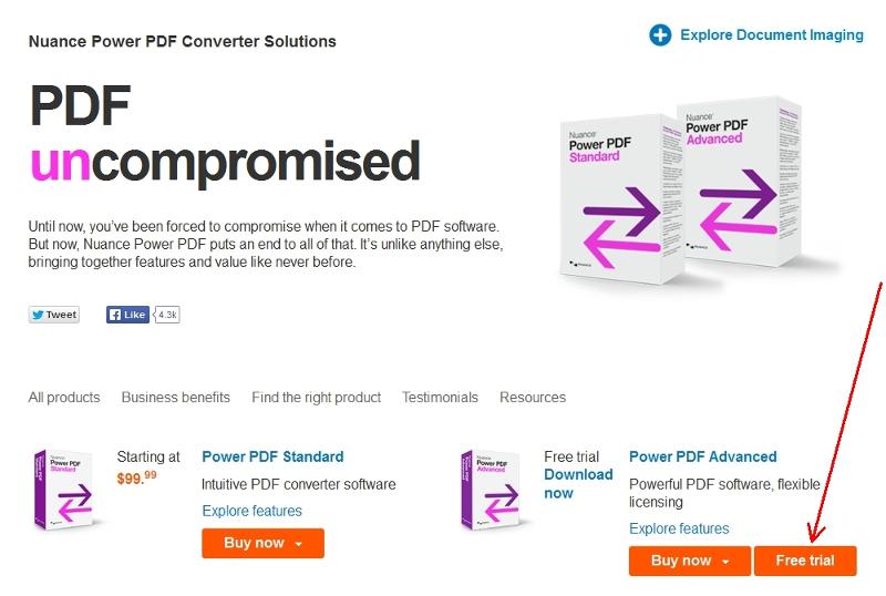

1. Download the trial software
Visit the Nuance website at:
http://www.nuance.com/for-business/document-imaging-and-scanning/power-pdf-converter/index.htm
Click the "Free trial" button, fill out the short form, and submit it.
Download the trial software and install it.
free trial
